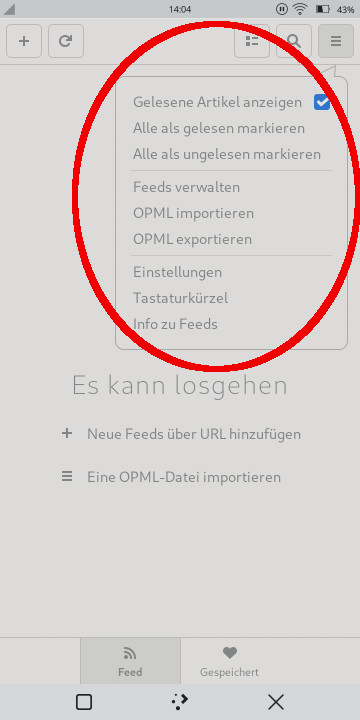

I got several apps, in which menus don't work. E.g. "Feeds" (RSS Reader):
The menu is showing, but when tapping on any menu entry, the menu simply disappears. Therefore I can't import an OPML file.

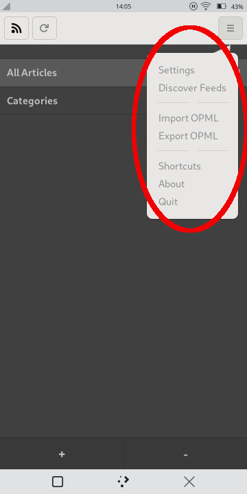

"News Flash" (also RSS Reader) shows exactly the same behaviour:
The menu shows, but tapping on any menu entry causes the menu to disappear. Neither here I can import an OPML file.
Currently I'm on Pinephone KDE (Manjaro/Plasma Mobile):
KDE Plasma Version: 5.22.5
KDE Frameworks Version: 5.86.0
Qt Version: 5.15.2
Kernel Version: 5.14.10-1-MANJARO-ARM
I'm sorry for the poor quality of the screenshot. The fading doesn't seem to work correctly yet, when using the built-in screenshot app.
Any ideas? Thanks!
You are trying to run gtk apps in KDE Plasma Mobile environment, which is Qt, qml, kirigami etc... and thus not the best way to do.
Try to find  your apps KDE counterparts eg. Alligator etc or switch to gtk/gnome mobile environment eg Phosh Smile
