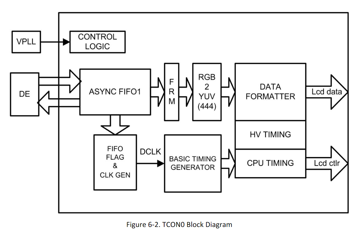

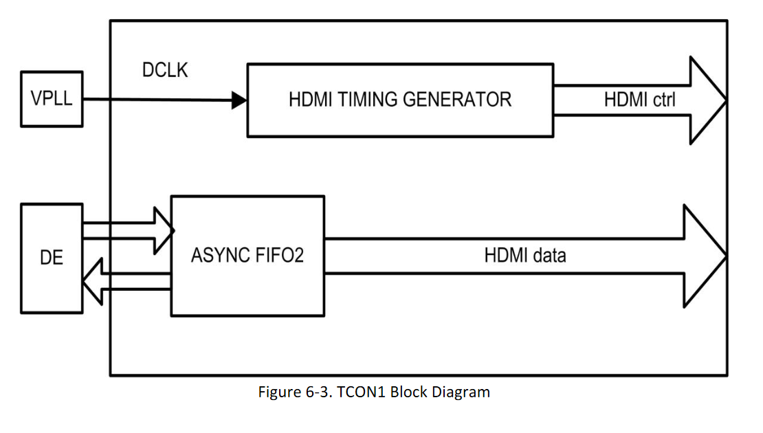

While the timing generators can be configured for other resolutions as well (see LCD output), one would have to figure out how to add new resolutions here and what is exactly supported by the hardware, but I think not all documentation for the AW Display Engine 2 are out in the open...
(from AW Usermanual)
Support LVDS interface with single link, up to 1366x768@60fps
Support RGB interface with DE/SYNC mode, up to 1920x1200@60fps
Support serial RGB/dummy RGB/CCIR656 interface, up to 800x480@60fps
Support i80 interface with 18/16/9/8 bit, support TE, up to 800x480@60fps
Support 4-lanes MIPI DSI up to 1920x1200@60fps
Support HDMI1.4 with HDCP1.2 up to4K@30fps
Support pixel format: RGB888, RGB666 and RGB565
Dither function from RGB666/RGB565 to RGB888
Gamma correction with R/G/B channel independence
4 interrupts for programmer LCD output 2
input source: DE sources
