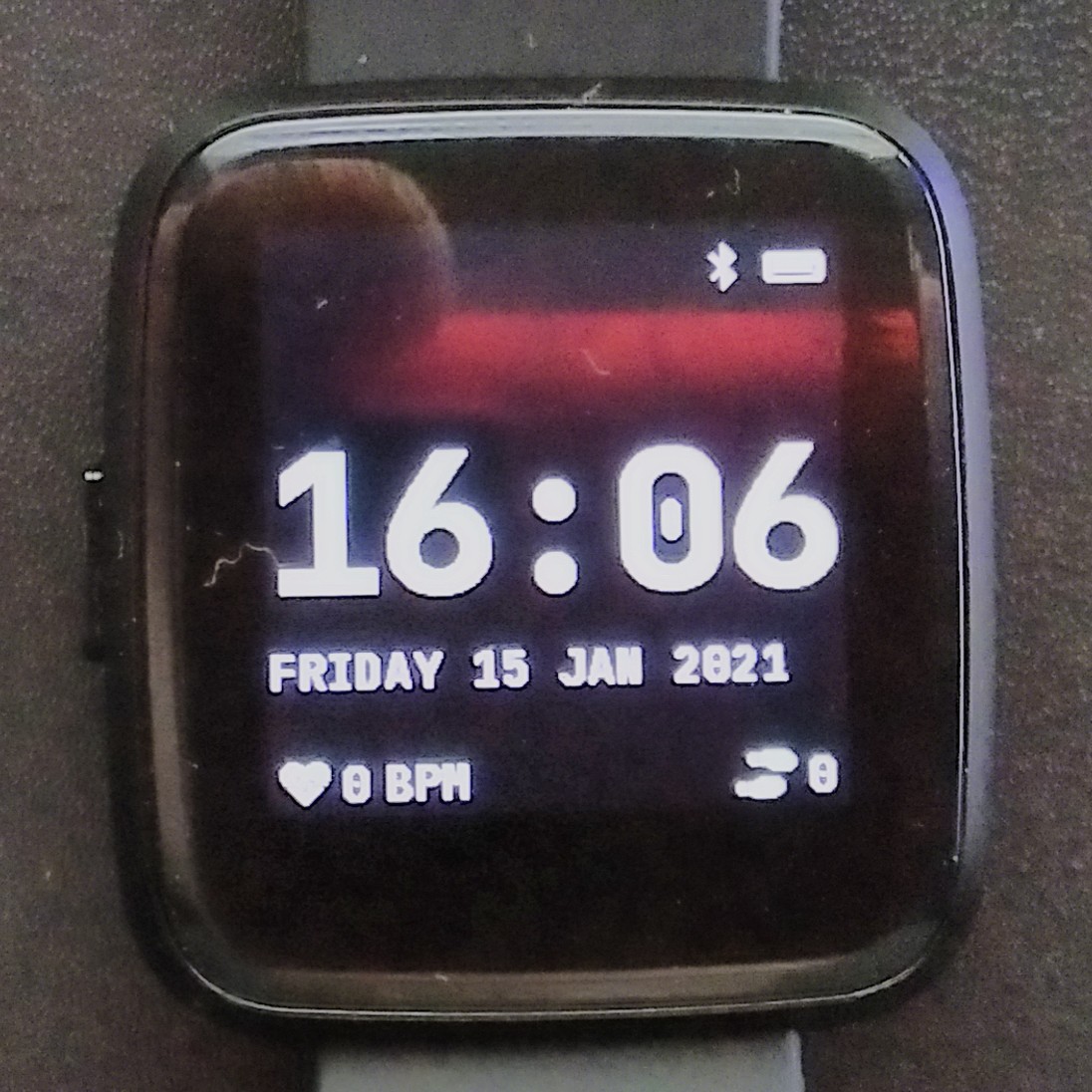

yesterday I got my three PineTime's. Installed was the firmware 0.7.1. I connected it to Gadgetbridge and the PT got the time.
So far so good Smile
The problem is that bmp and the stepcounter not work.
I updated to 0.10 but it do not help.
Have I to activate something?
Have anyone an idea?
M.

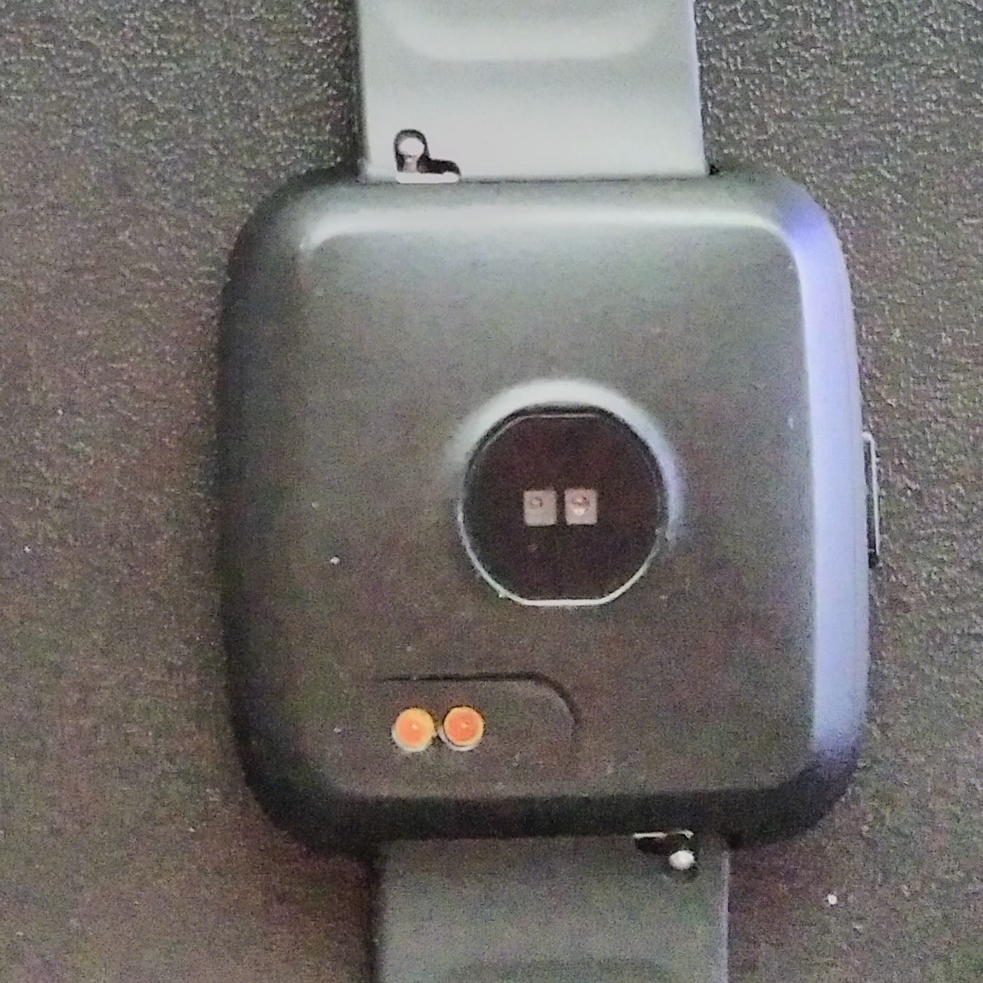

All tree PineTime's are showing the same mistake.
Is it possible to check the hardware? It is really depressiv Sad
@Martin87 These are development devices - not a finished product. The process is still ongoing.
As it happens, @JF002 I believe will likely release some code soon that provides heart rate data.

As @barray said, InfiniTime does not implement the heart rate sensor and the motion sensor for now. The label is a placeholder that was placed on the clock app a long time ago but their are not functional. For the record, I had working demo for both sensors, but didn't merge them because it was based on non-free/proprietary code and libraries.
The good news is that I've been working on the heart rate sensor recently, and I've just created the PR : https://github.com/JF002/Pinetime/pull/169. It's based on Wasp-os 100% open source implementation.
As the code is not fully debugged, I would advise you against flashing it on your sealed devices, though.

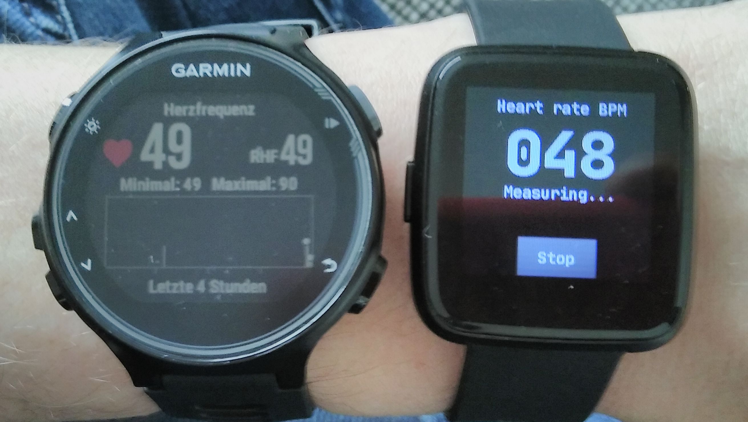

Yesterday I installed v 0.11.0.
The heart rate sensor works great! Smile
However the measurement is stopping, when the screen is going off.
It would be great to have a button, that deactivate the power off-mode from the screen. Then it would be possible to have a longer view on the measurement.
