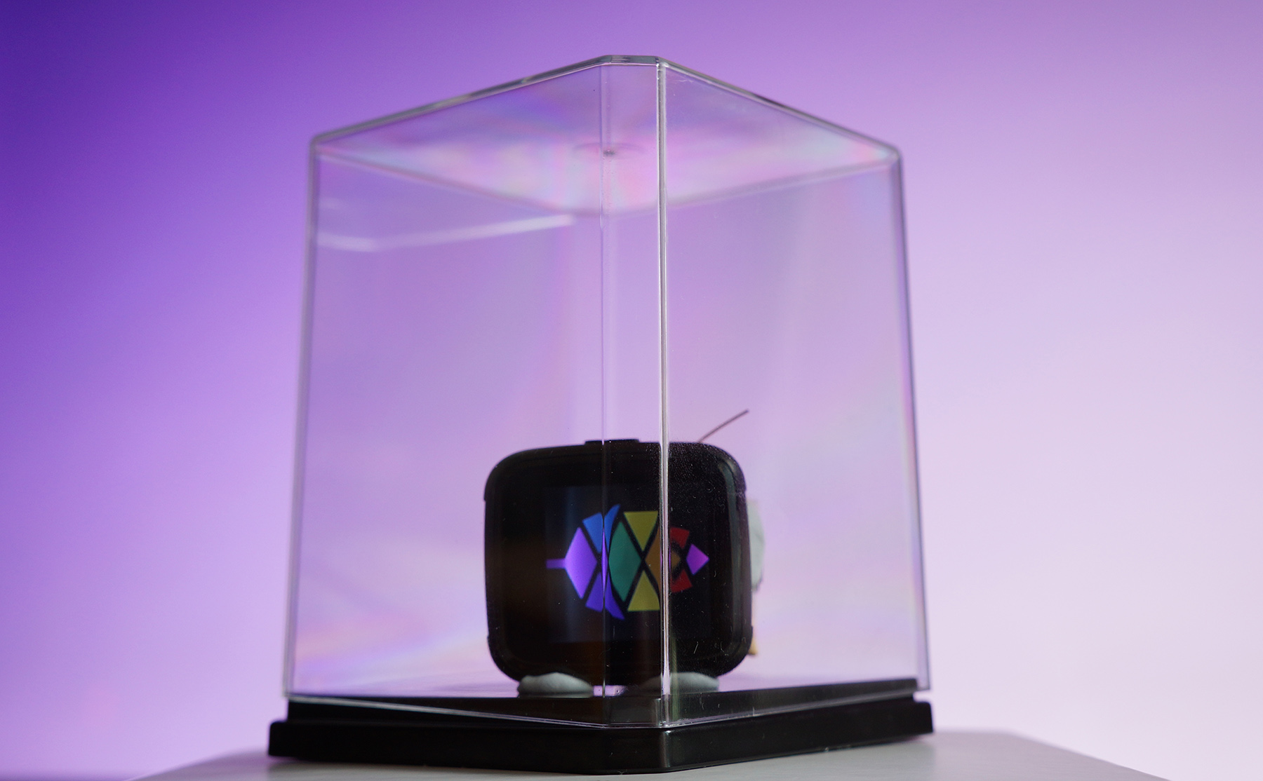

The new MCUBoot Bootloader (that we're loading into new PineTimes) shows a Boot Logo that's stored in External SPI Flash upon startup.
To change the Boot Logo, just prepare a 240x240 PNG file in 24-bit colour (or use a sample logo from the link below), and follow these steps...
PineTime Logo Loader
This calls GitHub Actions to create a custom firmware image (Mynewt) that writes the Boot Logo into External SPI Flash. The Boot Logo format (RGB565) is explained here...
MCUBoot Bootloader for PineTime Smart Watch
