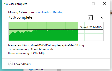

Using the same xenial longsleep image with a fresh samba install
I get consistent read speed of just over 20MB/s. Samba serves files
from the SD card (32 MB Samsung, as recommended by tkaiser).
The write speeds are around 15MB/s.
Check you SD speed , You you Sd read at low speed, Does not matter how fast the ethernet is
I suggest the 400X ones not the cheaper ones
