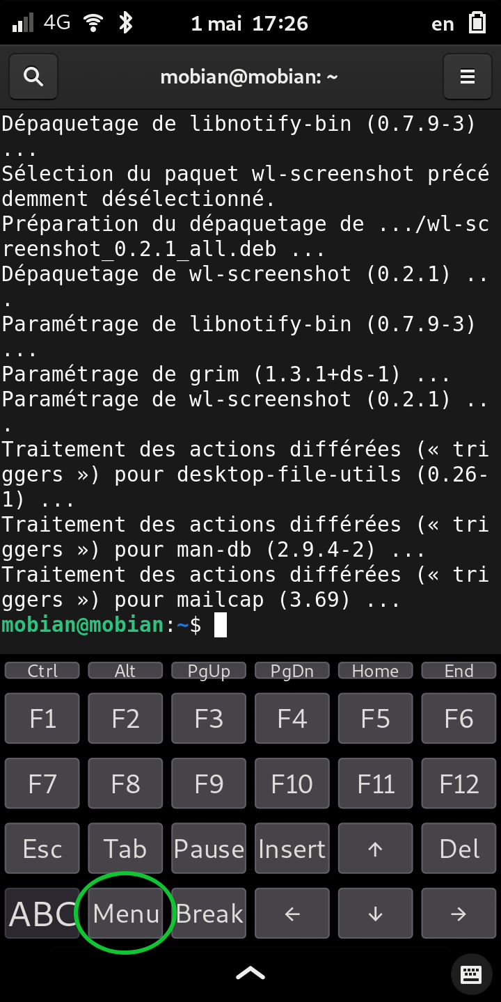

Simulating right-click is already available system-wide. Just switch to the terminal keyboard in squeekboard (it's available in any app now). Then press the ">_" key to get the screen with all the F keys. The Menu button (lower row, second button) acts like a right-click.
@NormandC Thanks for the reply. I'm runnning a newly upgraded Mobian stable, and this does not yet work for me. Also, this is kind of a cumbersome solution. Holding press would be better. But I will keep an eye out for this feature and try it once it becomes available.
