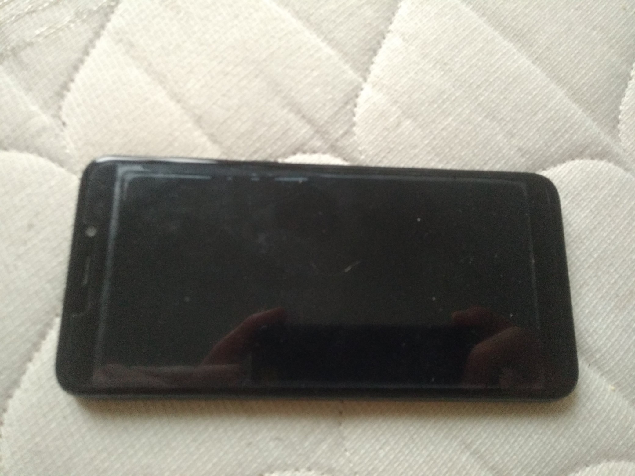

  • Could you, please, provide a couple of pictures of your delaminated screen?

  • I don't have any device to take convincing pictures right now, but here's one attached. It first started at the top-right corner. Then it spread across the upper edge of the screen and then on the left edge, starting from the top and spreading to the bottom. Quite like the picture given in the first post. It has now spread on the whole bottom and right edges of the screen. I noticed today that a second "layer" has started spreading at the top-right corner. I hope it won't spread too much, it is manageable for now but if the entire screen gets affected it will probably be a bit tough!

(05-23-2021, 12:51 PM)raph Wrote: I don't have any device to take convincing pictures right now, but here's one attached. It first started at the top-right corner. Then it spread across the upper edge of the screen and then on the left edge, starting from the top and spreading to the bottom. Quite like the picture given in the first post. It has now spread on the whole bottom and right edges of the screen. I noticed today that a second "layer" has started spreading at the top-right corner. I hope it won't spread too much, it is manageable for now but if the entire screen gets affected it will probably be a bit tough!
I'm not even remotely close to being an expert when it comes to the glues and screen lamination, but this sounds like a rather serious development of the issue.  Undecided  As a note, no picture was attached to your last post.

Arg. I forgot to click on "Add attachment". Here it is but I'll try to take a better picture if I have the chance.

(05-23-2021, 02:40 PM)raph Wrote: Arg. I forgot to click on "Add attachment". Here it is but I'll try to take a better picture if I have the chance.
This looks exactly as you've described it: a two-stage screen delamination, so to speak.
