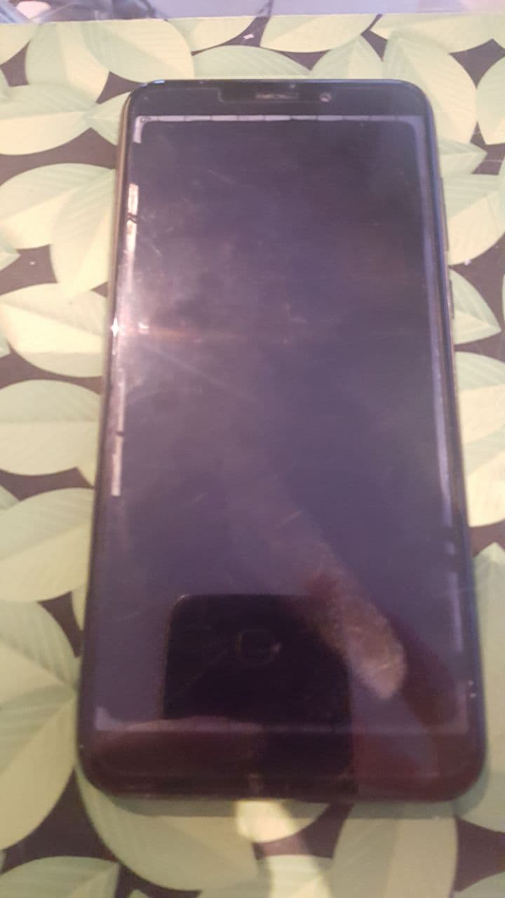

I'm afraid I'm having the same problem. Mine is the batch with the Manjaro logo on the back. Delamination around all borders, roughly 1 to 2 mm wide. I will order a spare screen but think you guys need to be aware of the issue.

(05-09-2021, 01:04 PM)RudderDuck Wrote: I'm afraid I'm having the same problem. Mine is the batch with the Manjaro logo on the back. Delamination around all borders, roughly 1 to 2 mm wide. I will order a spare screen but think you guys need to be aware of the issue.
I'm sorry to see that.  Just checking, has your PinePhone ever suffered some water damage?  Are you using it as your daily driver?
It never suffered water damage but sometimes use it when having bath Blush . I do think it started after that, so it may be humidity related. Almost switching to it as daily driver, I would say using it 5 out of 7 days as main phone. I'm happy that it is fairly affordable to replace, hoping it isn't too much of a job to replace screen.
