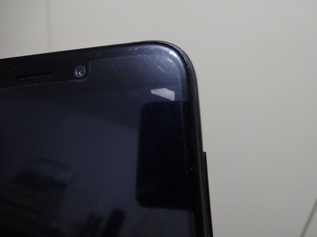

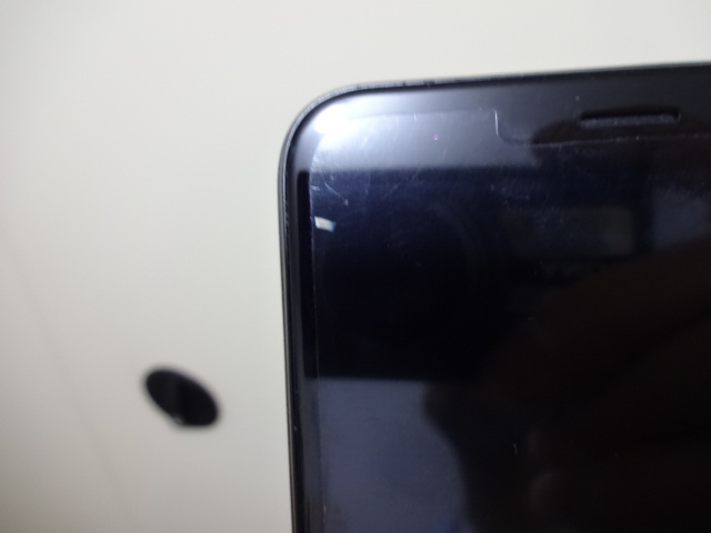

Screen dying already?

I think that I have the same problem, it is some little marks for the moment.
(04-25-2021, 01:31 PM)Gribouille Wrote: Hello,
That indeed does look like the same problem. It started out the same on mine, just not on the edges but in the middle.
After a lengthy chat session with @megous (Ondrej), the conclusion is that the screen delamination issue could be very well related to the heat generated by the CPU, which of course cannot be known for sure, at least for now.  This issue has also been brought to the attention of Pine64, thanks to @xalius, and the PinePhone production team will investigate the issue.
However, it's better to be on the safe side.  This issue might be simply a result of a bad batch of phones, which used bad or weak glue, but it's much better to have more restrictive CPU throttling configured on hundreds of phones, as a preventative measure, than to have dozens of screens damaged.  Maybe the heat isn't the root cause, but changing software settings is cheap, while replacing damaged screens isn't.
In other words, it's highly advisable that everyone configures more restrictive CPU throttling on their PinePhones, and reports back their experience (CPU temperature, how hot the screen feels to the touch, is there a noticeable slowdown, etc.) with different values for the CPU throttling parameters.  Based on the reports, changes will be made in the Linux kernel tree maintained by Ondrej, so the more restrictive CPU throttling eventually becomes the default.
There are even some plans for implementing system-wide dynamic thermal throttling, which would involve other components of the phone besides the CPU, but let's not jump the gun yet. Smile  This would also improve the overall safety of the phone.

The screen damage resembles the damage of liquid of other LCD-based phone screens, see for example https://i.imgur.com/0p4p26V.jpeg for a similar liquid-damaged screen. There are thermal safety-related warnings in the wiki now (see https://wiki.pine64.org/wiki/PinePhone#Thermal_Safety), I would exclude damage to the UV glue itself at these low temperatures as possible cause in any way however.
It's possible that these are bad apples, considering the low amount of reports of similar issues. Replacement screens can be bought under https://pine64.com/product/pinephone-5-9...ch-screen/ if you want to spare Pine some money, if not you can open a ticket under sales@ in case of a fault already existing insidiously.
(04-26-2021, 08:06 AM)fxc Wrote: The screen damage resembles the damage of liquid of other LCD-based phone screens, see for example https://i.imgur.com/0p4p26V.jpeg for a similar liquid-damaged screen. There are thermal safety-related warnings in the wiki now (see https://wiki.pine64.org/wiki/PinePhone#Thermal_Safety), I would exclude damage to the UV glue itself at these low temperatures as possible cause in any way however.
My phone never got wet. I never asked pine to fix or replace it. I simply bought another one. Cool
