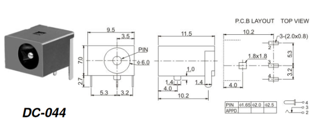

The part number is DC-044 and please refer to attached file
Thank you! I'm not looking for the barrel connector part. I'm looking for the 4-pin part. I'm pretty certain the 4-pin parts in this kit mate with what is on the RockPro64:
