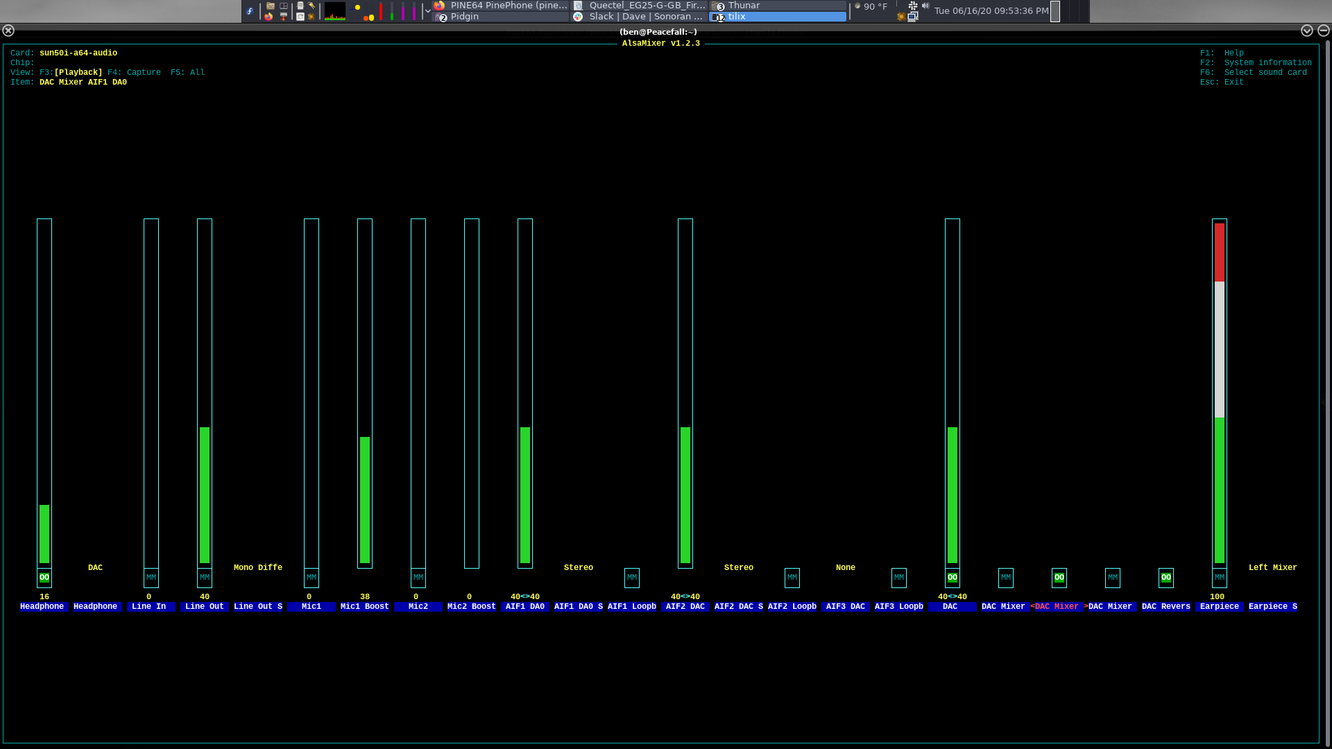

So, I've got my BraveHeart PinePhone fixed up fairly well. I got calls, texts and wifi working, and it's *almost* ready to be my daily driver.
Still got issues with bluetooth, seems running bluetooth at the same time as wifi makes both unpredictable and prone to disconnection, so I have to remove the bluetooth firmware to get a usable experience. That necessitates that I use the audio jack for sound.
No matter what I do, I can only get mono sound, and upon further investigation, it's only outputting on the left channel. I tweaked sxmo_megiaudioroute.c to use "DAC" instead of "Mixer" for the headphone output, set both channels enabled, etc, and then I didn't just get the left channel on both earbuds -- I got the left channel on the left earbud only, and silence on the right earbud.
Megi suggested I don't use that utility for music, but A. I do need phone calls, and B. even when I never use it, e.g. a fresh reboot, the issue persists.

Fixed it, adding some help for any other poor bastards who end up with this problem. ALSA was saving a bad state.
I've saved a correct one you can use for headphones, and included a screenshot of proper mixer settings in case your kernel has a different name for one of the controls.
Restore this state with 'alsactl restore -f headphones.alsa'

(06-16-2020, 11:12 PM)Subsentient Wrote: Fixed it, adding some help for any other poor bastards who end up with this problem. ALSA was saving a bad state.

This is probably something that's going to vary from distro to distro depending on which mechanism they're using to handle audio profiles. Saving and loading alsa mixer state is one approach. Profiles using alsaucm is another (see under /usr/share/alsa/ucm and/or /usr/share/alsa/ucm2). PulseAudio may present another option. Anything that's saving user changes really ought to have a 'revert to system defaults' option to get to known-good settings.
