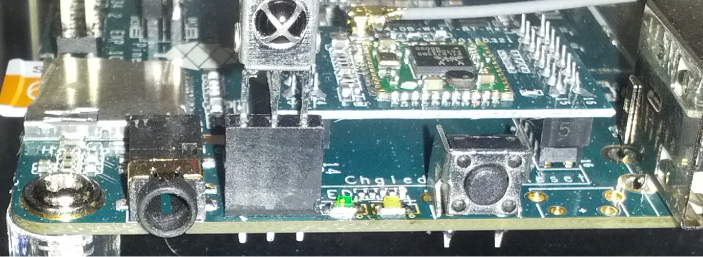

I think he's referring to this LED. Can it be accessed from CLI?
[Image: Pinepowerled.jpeg?dl=1]
they're talking about this LED connector.
Ah. I didn't see that connector. Well heck! Now I want access to both! Big Grin

Running the leny debian 8 image I measured the system led points to be a 600 millivolts. So it looks to be powered on.
(06-03-2016, 04:36 PM)JamesHarris Wrote: Running the leny debian 8 image I measured the system led points to be a 600 millivolts. So it looks to be powered on.
Hm... 0.6v shouldn't be enough to make a LED light... they usually want between 2.1 and 3.2 volts depending on the type of LED. I soldered leds onto mine, and the system led isn't lit up at the moment. I don't have a lithum battery on my pine64 atm, so there's no reason reason for the charge led to light (which it isn't).

The right (yellow one in this case) one is the charge led and is connected to the PMIC, the other is connected to a GPIO and you can do whatever you want with it. If you look at the schematic you will see that the resistors are set for a current of about 5mA...
echo 359 > /sys/class/gpio/export
echo out > /sys/class/gpio/gpio359/direction
echo 0 > /sys/class/gpio/gpio359/value
To turn the LED on for example.

Here is mine.
I will also point out that the sys LED pictured is 'reversed' logic... so, we're providing a ground shot to the LED-- when the value is 1 the LED is off, when the value is 0 the LED is on.
The GPIO(s) can either source or sink... so they can be wired either way... this one is wired sink (ground shot turns on).
