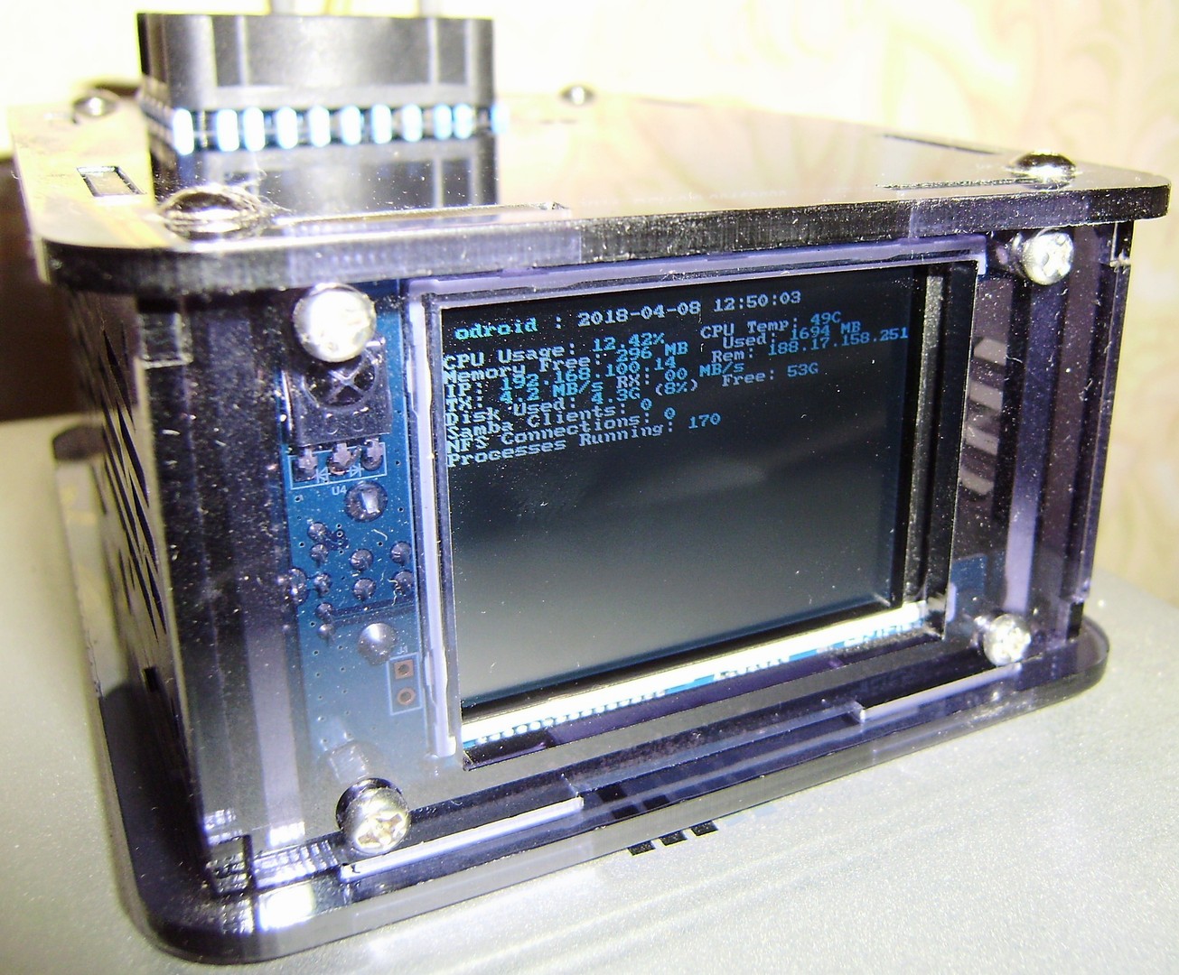

I do not yet have this board, I ordered and I wait for my next arrival in the middle of September …
at the moment, I use as a NAS/MySQL/Apache server the ODROID-XU4 (chip Samsung Exynos 5422),
its temperature regime is approximately the same, on it I start the fan with +35С,
DRIVER=="odroid-fan", ACTION=="add", ATTR{fan_speeds}="1 15 70 99", ATTR{temp_levels}="35 45 50"
1% PWM Duty < +35C (STOP), 15% PWM Duty > +35C, 70% PWM Duty > +45C, 99% PWM Duty > +50C
and the temperature does not rise above +50°C
