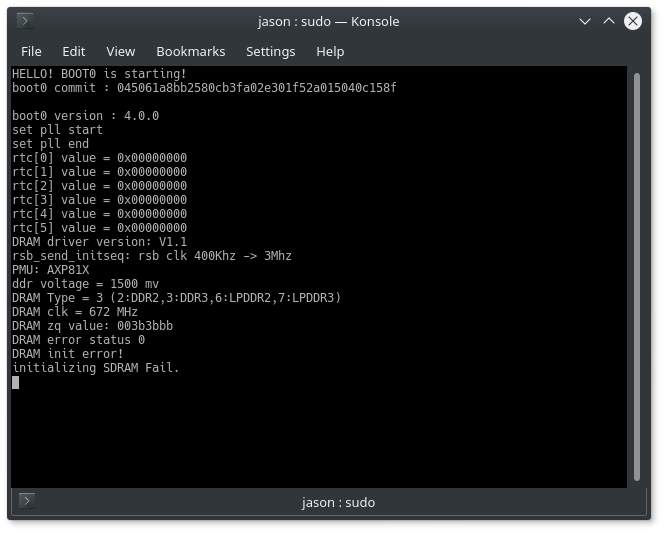

Just got my Clusterboard + SOPINE today and very excited to start experimenting.
I inserted the SOPINE, hooked up a serial adapter and powered it up.  The screen attached is what I got.
I'm hoping that I just overlooked something and that this doesn't mean what I think it means...
I think I got this figured out (wrong OS image, duh).
yeah, sopine is LPDDR3 RAM , needs sopine image.
