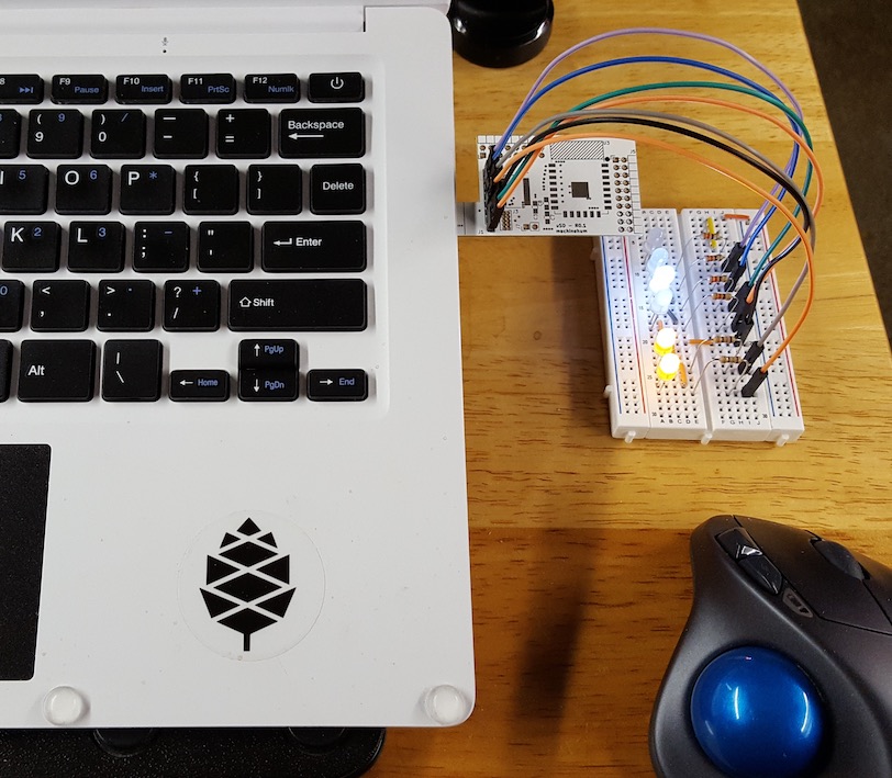

The uSD Breakout blanks R0.1 came in the mails today from Canada; I'll begin full testing tomorrow when preliminary continuity and SD header testing is complete with the meter. The boards look great; looking forward to getting them into the Pinebook soon. edit: The latching mechanism works brilliantly; tested on my SD card tester and SD sniffer; quite nice. Thanks again ! Continuity tests checkout on the SD header; all pins accounted for, no shorts, all pins line up in the latching mechanism precisely (perfect) on the micro scope, card specs are precise and the latching mechanism actually works well ( out of all the cards that I have tested for this purpose this is the first card that meets the specs ). nice job, will begin the SD header tests now...
marcushh777
please join us for a chat @ irc.pine64.xyz:6667 or ssl irc.pine64.xyz:6697 ( I regret that I am not able to respond to personal messages; let's meet on irc! )
10-07-2017, 12:13 AM
The trial run of the uSD Breakout ( by machinehum ) is proving to be brilliant ! ... the in-machine latching mechanism works flawlessly; clicks in place, is positioned correctly, and inspection under scope indicates that the contacts are tracking right down the center of the pin pads precisely ( perfect ). The trial run was flawless; all six gpio pins functioned normally -- the pins are in the right order and the led_lab functioned as expected ( and somewhat better, I might add, than the commercial card from Sparkfun ). Of course I have not populated the board yet; all in good time. Thank you machinehum; brilliant ! Note: ofc for the commercial version, I would recommend gold contacts.

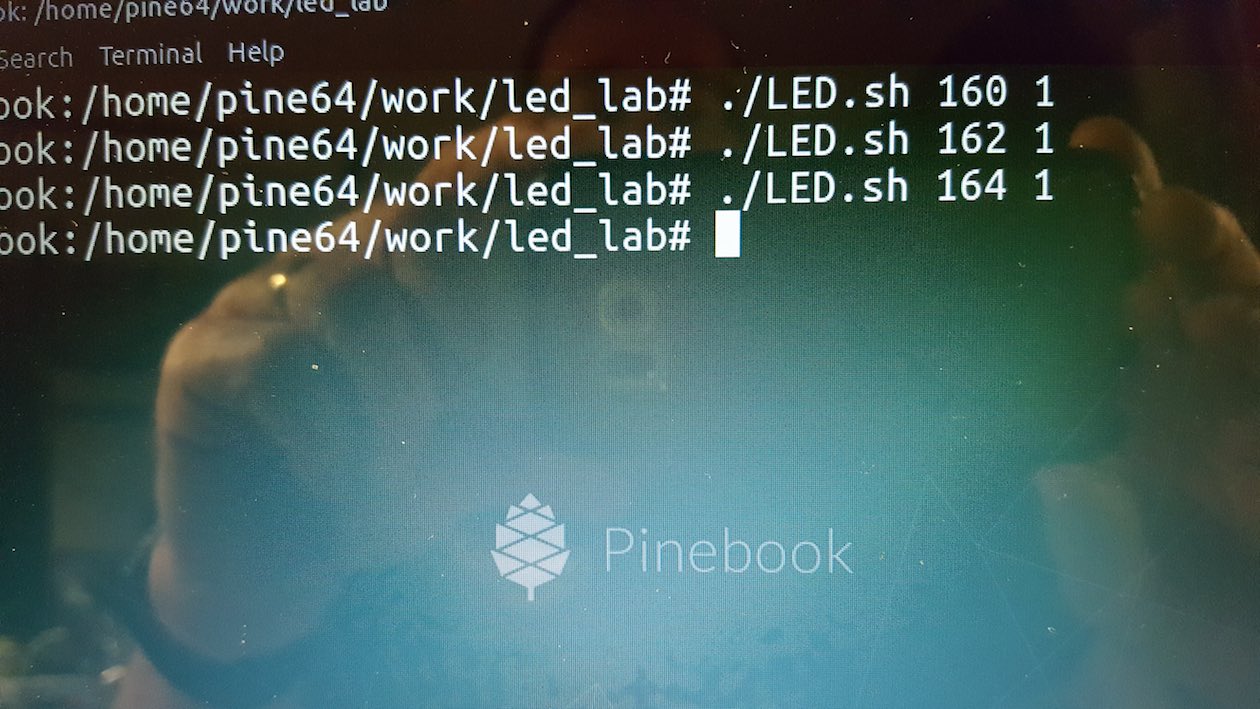

PIN-setup.sh Code: #!/bin/sh
echo 160 > /sys/class/gpio/export
echo 161 > /sys/class/gpio/export
echo 162 > /sys/class/gpio/export
echo 163 > /sys/class/gpio/export
echo 164 > /sys/class/gpio/export
echo 165 > /sys/class/gpio/export
echo out > /sys/class/gpio/gpio160/direction
echo out > /sys/class/gpio/gpio161/direction
echo out > /sys/class/gpio/gpio162/direction
echo out > /sys/class/gpio/gpio163/direction
echo out > /sys/class/gpio/gpio164/direction
echo out > /sys/class/gpio/gpio165/directionexample: ./PIN-setup.sh LED.sh Code: #!/bin/sh
echo $2 > /sys/class/gpio/gpio$1/valueexample: ./LED.sh <gpio> < 0|1 > ./LED.sh 160 1 ./LED.sh 160 0 blinker.sh Code: #!/bin/sh

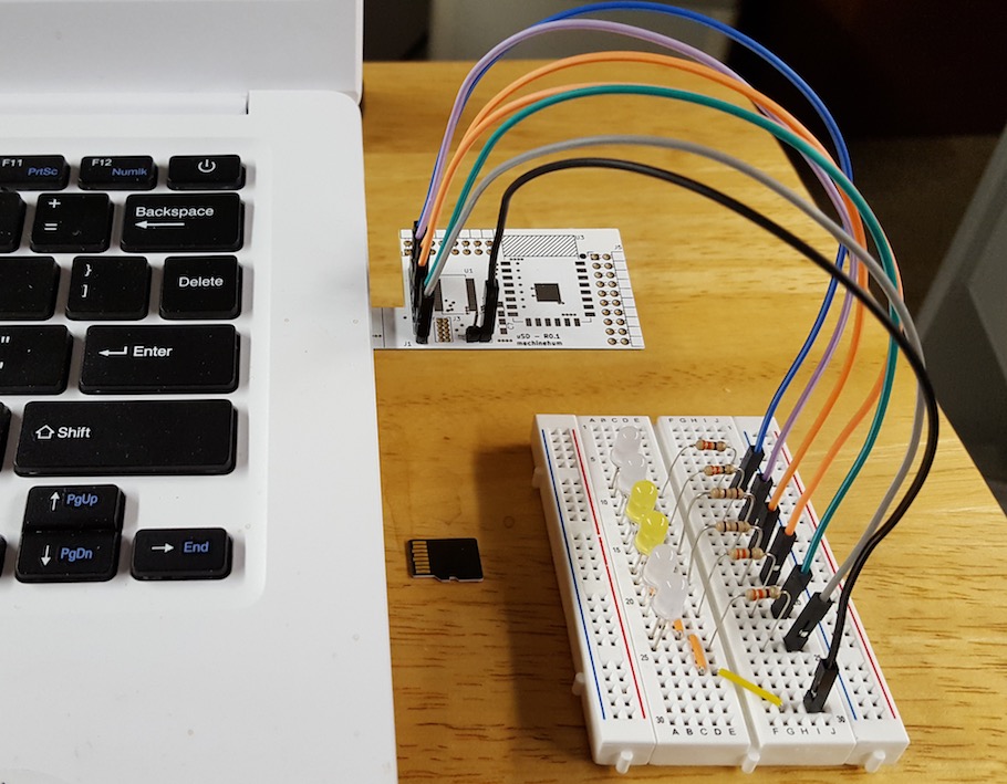

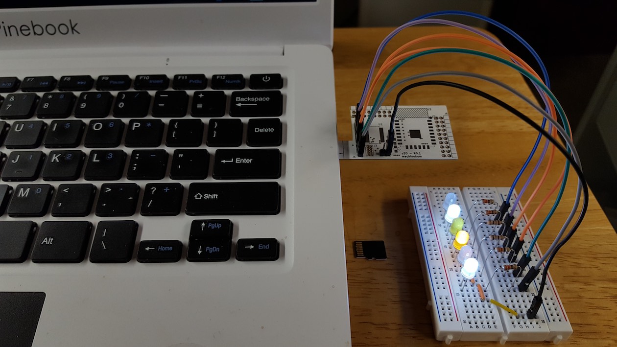

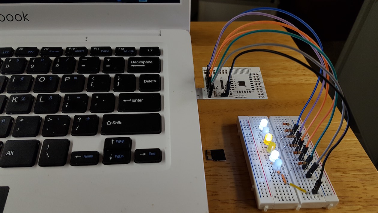

doneexample: ./demo_LED.sh <count> ./demo_LED.sh 12 (each section of the demo loops 12 times) For those of you testing the machinehum uSD Breakout, the above scripts will give you something right-away to play with using an led_lab ( described below, see pics above ) and your Pinebook. Place all ten (10) of the scripts above in a working directory on your gnu+linux Pinebook image, and use sudo -i to run the demo_LED.sh script ( or any of the other sub-scripts ). Each script has been given a title ( important, since they call each other ) and examples following. The led_lab is six (6) LED(s) on a common cathode ground plane; the anodes are driven (sourced) by the six (6) SD pins. I used low power ( 2-3 ma ) LED(s) in the following combinations with ballast resistors listed in ohms: white-330, white-330, yellow-180, yellow-180, white-330, white-330 gpio160 - gpio165 ( at this point i am not using the MCP23S17, nor the Padi Stamp ) Note: see this link to get the information regarding modification of the dts|dtb ( very important ) !
