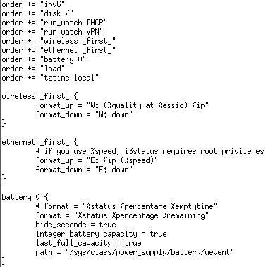

Now I am working on getting the battery information in the bottom right i3 status bar. I have managed to get it to no longer show "No Battery", as you can see in the screen caps below, it will show white when it is plugged in and red when it running off battery. What I am having difficulty getting is battery percentage or run time. It will either show 0 or if change to the format line that is commented out in the /etc/i3status.conf file it will show the current system time in the battery area (not time left in the battery or time till full charge).
I have tried changing it from "battery 0" to "battery 1" as well as verified the path is correct. I looked at the contents of uevent and it looks like similar info to another Linux laptop that I have access to.
Is there some sort of a power management program that is a dependency for this work?
Any other ideas for me to try to get the battery percentage and remaining time to work?
Thanks in advance.

Sorry to bring the old topic up. In case you have not found a solution yet, have a look at my custom script that adds the battery status properly to i3status:
https://github.com/kasramp/PinebookScrip...3status.sh
Feel free to ask questions.

(08-18-2017, 10:13 AM)n3rDy Wrote: That's great k_mp, thanks for the hard work on this. I haven't been able to spend any time working on this lately, so I am currently using Mate. I would really like to use the PB as my daily driver with i3, the next challenge would be standby when the lid is closed.
Where should this shell script be located once I download it? Once I run the script, will it always run? Or does it need to be called on startup or as a cron job?
No worries n3rDy. You just need to download the script and copy it to ~/.config/i3. Then edit your i3 config file, which is also located at ~/.config/i3 and add the script path and name in front of status_command under bar { section. You can refer to this sample configuration as well: https://github.com/kasramp/PinebookScrip.../i3/config
Once you have done with the changes, just save it and then press Mod + Shift + r, you should be able to see the battery status in the left side in a second or two.
To get rid of the non-functional battery status of i3, edit the file at /etc/i3status.conf and comment order += "battery 0" line.
And yes the script is running automatically and doesn't require any cron job.
