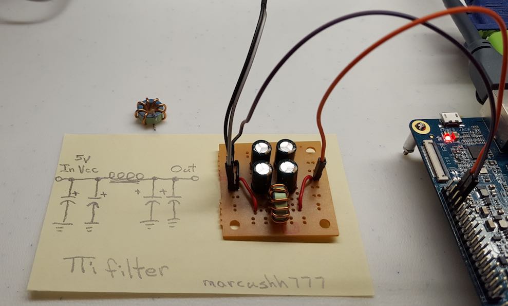

Addendum:  PI  low_pass  filter:
This little device pictured above has been discussed on the forum (and the irc channel) often enough that it warrants further explanation and an hour of my time this afternoon.  This is called a low-pass or PI filter (PI because of the shape the schematic makes). The device cleans up noisy DC line voltage by 'passing' the DC voltage and blocking the noise (RF signals, dc-dc converter noise, automobile noise, &c).  This little filter can take a 100mv ripple in the DC line voltage and quiet it down to less than 10mv literally. It is a passive circuit, requires no energy (very little), and is relatively easy to build, even by novice EE maker types.
All four capacitors are 6.3v 1000mf caps (taken from an old PC planar board) and the toroid inductor is also a very common PC planar board inductor (in fact, these components were pulled off an old ACER planar this afternoon, and were themselves used there as a low-pass filter!)    ( they live again... isn't resurrection marvelous ! )
This device is particularly handy if your DC power cord is very long, if you live in an area with high electrical noise or radio towers, or if you plan to put your PineA64 in your automobile.
In the pic above I am powering the PineA64 with a 12v batt (3000mah, SLA) using the 'CPT Car Power Technology' DC-DC converter;  it takes input of 7v - 50v (10 Watt) and has an output of 5v @ 2000ma.
Again, I am feeding the 5v out from the DC-DC converter through the PI  low_pass  filter;  this is important when using most DC-DC converters, because they typically produce noisy outputs.  The PI filter will reduce the noise on the DC line input to the PineA64 producing a nice clean quiet stable power source!
Note: CPT comes with a micro usb connector output; I removed the connector-- I was pleased to find a good two wire cable under the sheath and I decided to feed the power to the euler bus +5v to pin(4) and the ground wire negative to pin(6). This makes the connection 'solid' and by-passes the weak micro usb connection. This is preferred for most robotics applications.
This is the solder side of the PI filter board. The important thing to note is that it is simplicity itself. Anybody can do this !
This is a close-in of the finished PI filter.  The point to note here is the male header pins. I always build small projects like this with header pins so that setup and tear-down is easy with jumper wires; also the same component can be swapped in when needed in other projects.

... again, this very much a beginner soldering project; just dive in and try it !
The full system running on 12v batt !
In this second filter I rewound the toroid inductor (doubled the windings) and moved all the pins to one side of the board, will facilitate easier mounting in the boat's weather proof case.
The pic above is a close-in of the hand-wound toroid inductor. I pulled the inductor from an older PC planar board and removed the original 10 wrap winding.  Then, using enameled coper wire, I replaced the wrap with twenty turns; this also is very easy to do; although tedious, and maybe a little boring. Confused

This PI filter is yet another option for arranging parts swiped from an older Epson printer power supply board.  The inductor is not a torroid (as the others) and I have simplified the caps down to one on either side of the inductor.
This filter is being used to feed the Android playdesk via the euler bus, pin(4 5v+) and pin(6 ground).
