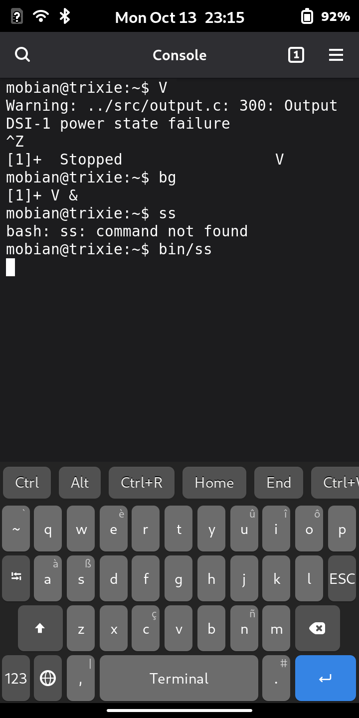

This is a regression since wayvnc works on bookworm, the image even rotates when the pinephone is rotated. I found 4 groups with user mobian on bookworm but not on trixie (render, video, dialout, and input) and did sudo usermod for each one by one logging out then logging back in. Nothing changed for the wayvnc even after a reboot.
As to no error, when I start wayvnc in trixie, I get:
"Warning: ../src/output.c: 300: Output DSI-1 power state failure"
I also get this warning but it seems timed to screen switching to power save, not to starting wayvnc. the bug could be something to do with color depth (different on the ppp and pp I believe). meaning there's an overflow in the mapping from sent bytes to rendered pixels.. and it there's no warning/error trap for that in the code. it "thinks" it's displaying just fine. that should not be a regression, though (did it work on the ppp or just the regular pp)?
