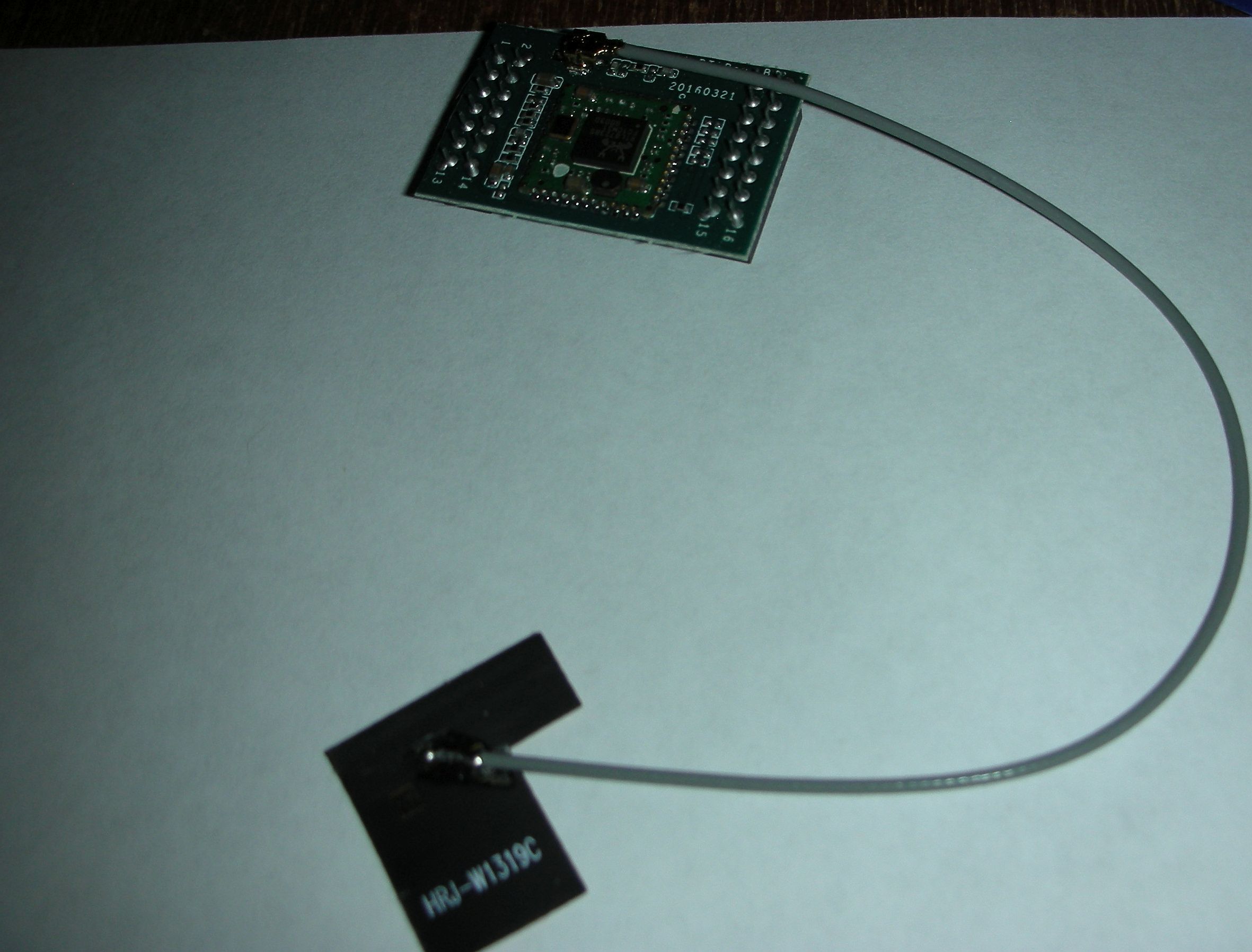

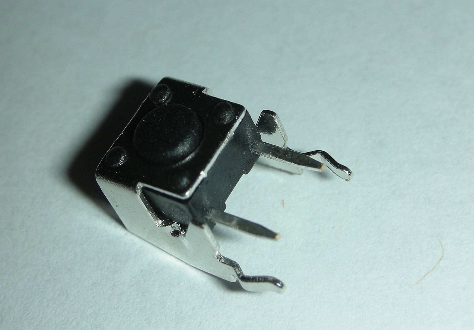

I need help identifying the parts delivered and how to install them. The second attached picture shows what I believe is the wireless adapter. Correct? How do I install it?
The first attached photo shows a very small piece, just 9 mm in length and 6 mm across. What is it? And
how do I install it?
(06-10-2016, 01:31 PM)clawinus Wrote: I need help identifying the parts delivered and how to install them. The second attached picture shows what I believe is the wireless adapter. Correct? How do I install it?
The first is the ''power button''. You have to solder it onto the board if you want to use it.
The second is the WIFI/BT module. It's very easy to install it. You just have to gently push it down to its serial ports as shown in the pic. http://files.linuxgizmos.com/pine64_pinea64_detail.jpg It's pretty straightforward procedure as from one side the bus on the WIFI chip is shorter than on its other side.
Thanks very much for your help. I will live without the power button.
As you pointed out the sides fo the wifi module are different, so it is
easy to put it in the right way.
But what about the attached wire with a metal plate at the end? Is that some kind
of antenna? Where does it go?
The grey wire is coax which is a shielded wire connecting the antenna at the end (the sticky black pad) to the connector on the board. Meaning the important bit is the sticky bit at the end - that is the wifi antenna! You just put that anywhere, but preferably as far away from board as possible, to be as far way from the electrical interference they generate. Really depends on how strong your wireless signal is and how far away the pine64 will be.
In one of the reviews of Pine64 I found an image indicating
that the coax cable can be turned in any direction. I will wait
assembling the unit until I receive the enclosure.
Many thanks for the quick reply.
