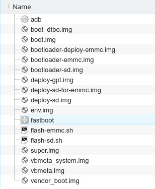

ather than the SD-Card version, as
(08-22-2023, 01:27 PM)fxc Wrote:
(08-22-2023, 02:20 AM)Ctrl_Amiga_1070 Wrote: Tried to find an IMG file to download for emmc flashing, but I get an uncompressed folder with like 5 or 6 .IMG files.
Very confused about this.
So I tried the other method of sd-card IMG
I downloaded this file
gd-lineageos-pinephonepro-userdebug-2023w13.tar.gz
rather than the SD-Card version as I am having difficulty getting the pine64 to boot with the sd-card inserted
and it extracted to these multiple .img files. I don't know which one to write. And FYI, no I am not being mad with you, I am grateful for your assistance, but I am aware of how .img files work. I used to Image my primary HDD to backups, but 8TB takes to long and purchasing a second and third 8+Tb just for a backup is a waste of money.
GloDroid is more complicated to install than other operating systems. See the instructions at: https://github.com/GloDroidCommunity/pin...ing-images.
Also note that GloDroid does not have all the hardware working yet, especially on the PinePhone Pro, see https://github.com/GloDroidCommunity/pin...o/issues/1.
I would suggest first reinstalling Manjaro to the eMMC to hopefully get the phone working again. Then if that works, you can try out GloDroid on a microSD card. If it still will not boot from the SD card, you can try to reinstall Tow-Boot to the SPI from a Manjaro session. What you should also check on Manjaro is whether the volume buttons are physically working, because if those do not work properly, then it is no wonder holding them in Tow-Boot does not work.
(08-27-2023, 11:20 PM)Ctrl_Amiga_1070 Wrote: ather than the SD-Card version, as
As the other user wrote, flashing GloDroid is highly involved. It requires booting a specially crafted microSD card image to get Android Fastboot working on the Linux phone and to then flash the phone from there. Also it doesn't have many contributors and not many users, because what's the point of Android on a PinePhone? Plus it is not compatible with Tow-Boot, so you won't get it running easily. And almost nothing will run and it will be very buggy. I would recommend to simply flash a Linux distribution, instead of GloDroid.
