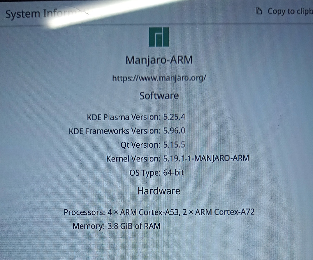

adding image of Manjaro "system screen"

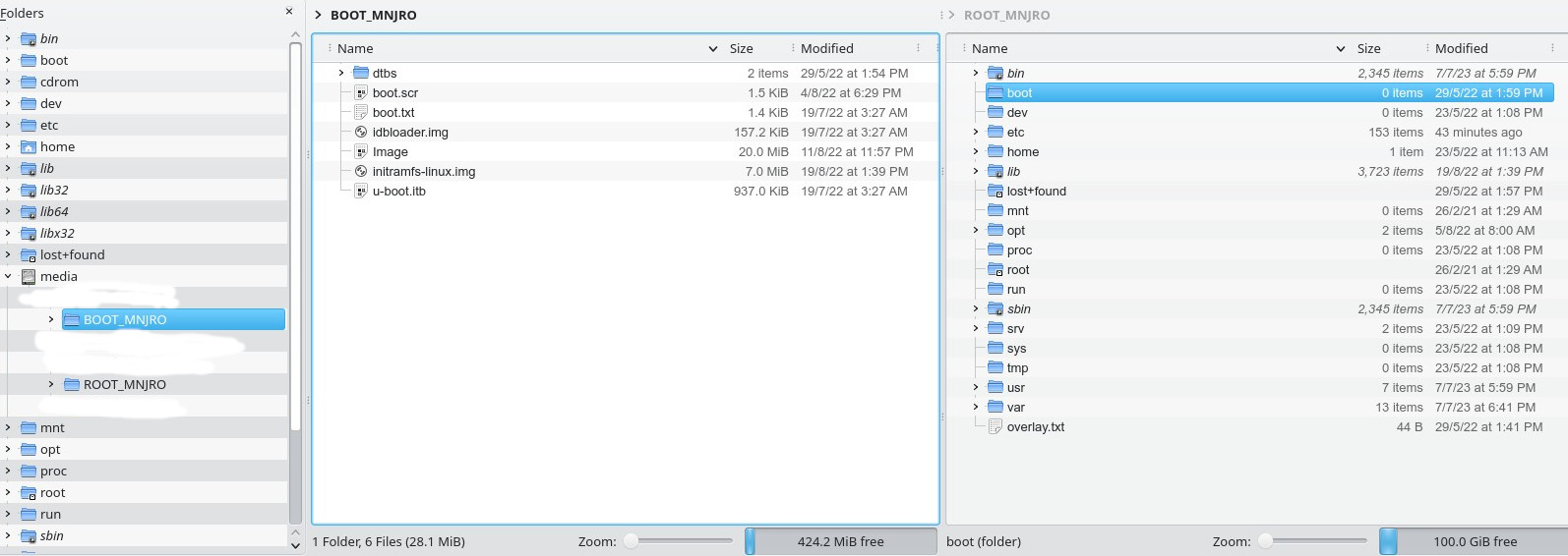

(07-26-2023, 07:06 PM)Ctrl_Amiga_1070 Wrote: I finally managed it, just now (why I am starting this thread) I think into fastboot mode. I have a permanent BLUE led, with usb cable connected to LINUX. However I can see two (2) new devices on my Linux PC.
BOOT_MNJRO
ROOT_MNJRO
I have access to both of these.
What do I do, Please?
Those are the 2 partitions on your phone's eMMC. You can mount them, but if you want to install a new OS, you will want to instead flash an image onto the entire eMMC, not mount the preexisting partitions on it.
See: https://wiki.pine64.org/wiki/PinePhone_P...o_the_eMMC
