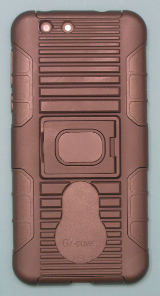

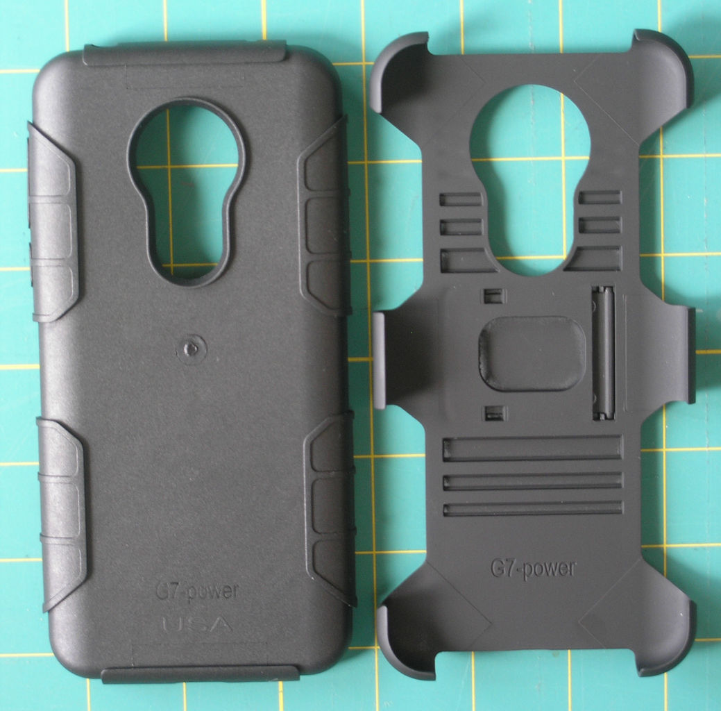

I can now report that a case designed for the Motorola Moto G7 Power is a decent fit on a PinePhone.[1]
This particular case design seems commonly associated with the vendor "nakedcellphone", but I ordered elsewhere and mine arrived completely unbranded. It's anyones guess who commissions/makes/sells these. There are versions of this case available for multiple different phones, including others with sizes similar to the PinePhone (e.g. Samsung Galaxy XCover Pro and LG K50/Q60).[1] I chose the G7 Power version because its camera hole is not too close to a corner, and the hard shell attachment points have rotational symmetry. The case arrived with a glass screen protector and a holster with a spring clip. The screen protector is a bit too narrow for the PinePhone, but would still protect most of the screen. I have no real complaints about the belt holster, though I don't intend to use it. Almost all the hard plastic of the case & holster has either a thin rubber coating or a very fine texture. I hope it's the latter for the sake of long term durability, but in either case, repeated use of the holster will wear some areas of the case & holster smooth and shiny. The holster does offer fantastic screen protection, at least while the phone is not in use.
This case does need a few modifications to work well with the PinePhone, but they should not be too difficult. I intend to install the hard shell upside down, so that I can cut a hole for the PinePhone camera without coming too close to the original camera hole.

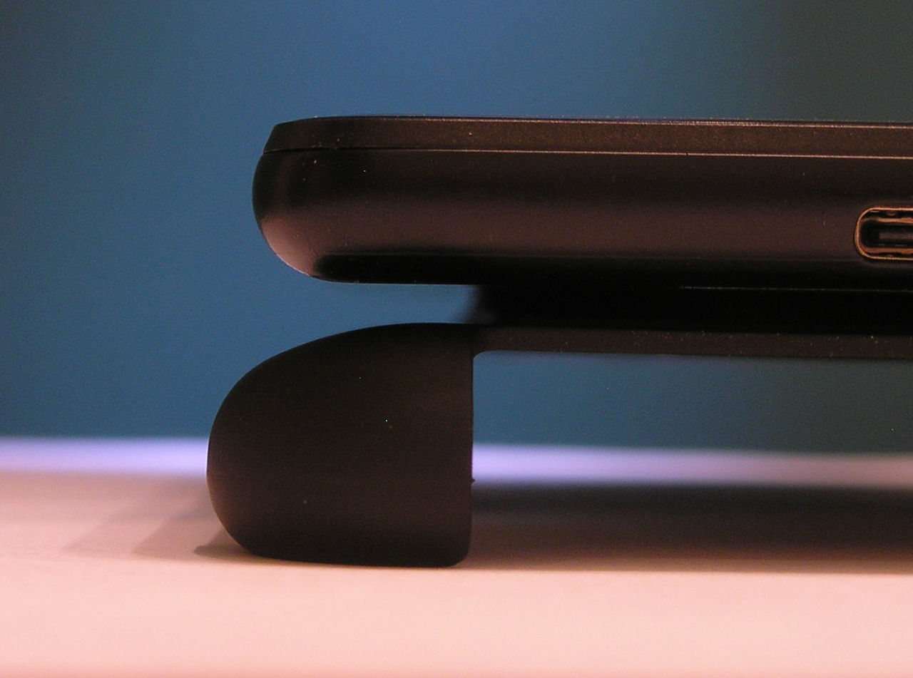

Unmodified. Note the center is fortunately not a magnetic stripe eraser, but just a metal plate.
Unmodified.
Unmodified.
Unmodified.

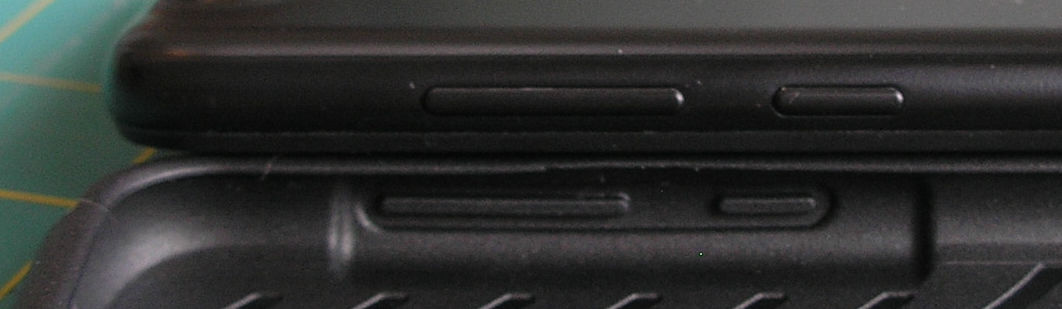

Unmodified. The button depressors somewhat line up. The volume buttons work fine. The power button works but exhibits very little tactile response. I have not decided what to do about this.
[1] Unfortunately, Motorola seems to have used the same model name on phones of different sizes. The Moto G7 Power referenced here is supposedly the USA (or maybe North American) version, measuring 160.83x76x9.4mm. There is supposedly also another version (possibly for the European and/or other markets), measuring 159.43x76x9.3mm. On a related note, the Moto G7 Power, Moto G7 Supra, and Moto G7 Optimo Maxx may have the same form factor in the US (/NA?) market. I do not know whether a Supra or Optimo Maxx is marketed elsewhere, and if so, what dimensions they have. There may also exist another Supra phone with different dimensions.
EDIT: Be sure to read my following posts. This case has some shortcomings.

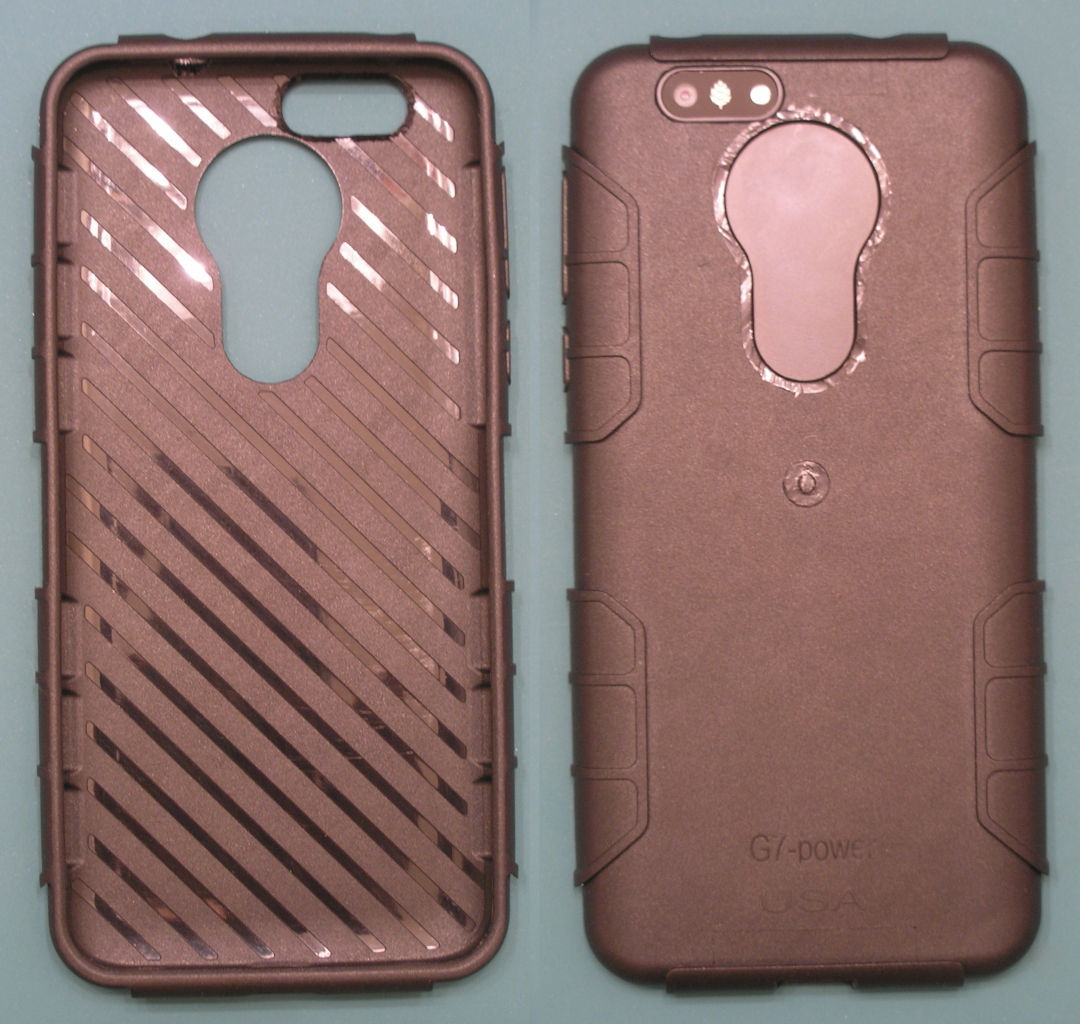

To keep the corner as strong as possible, I made the camera and flashlight hole no larger than necessary.
I have not yet made an opening for the speaker. I've considered drilling multiple little holes through both hard shell and rubber, or instead cutting a channel in the rubber from the speaker to the original camera hole.

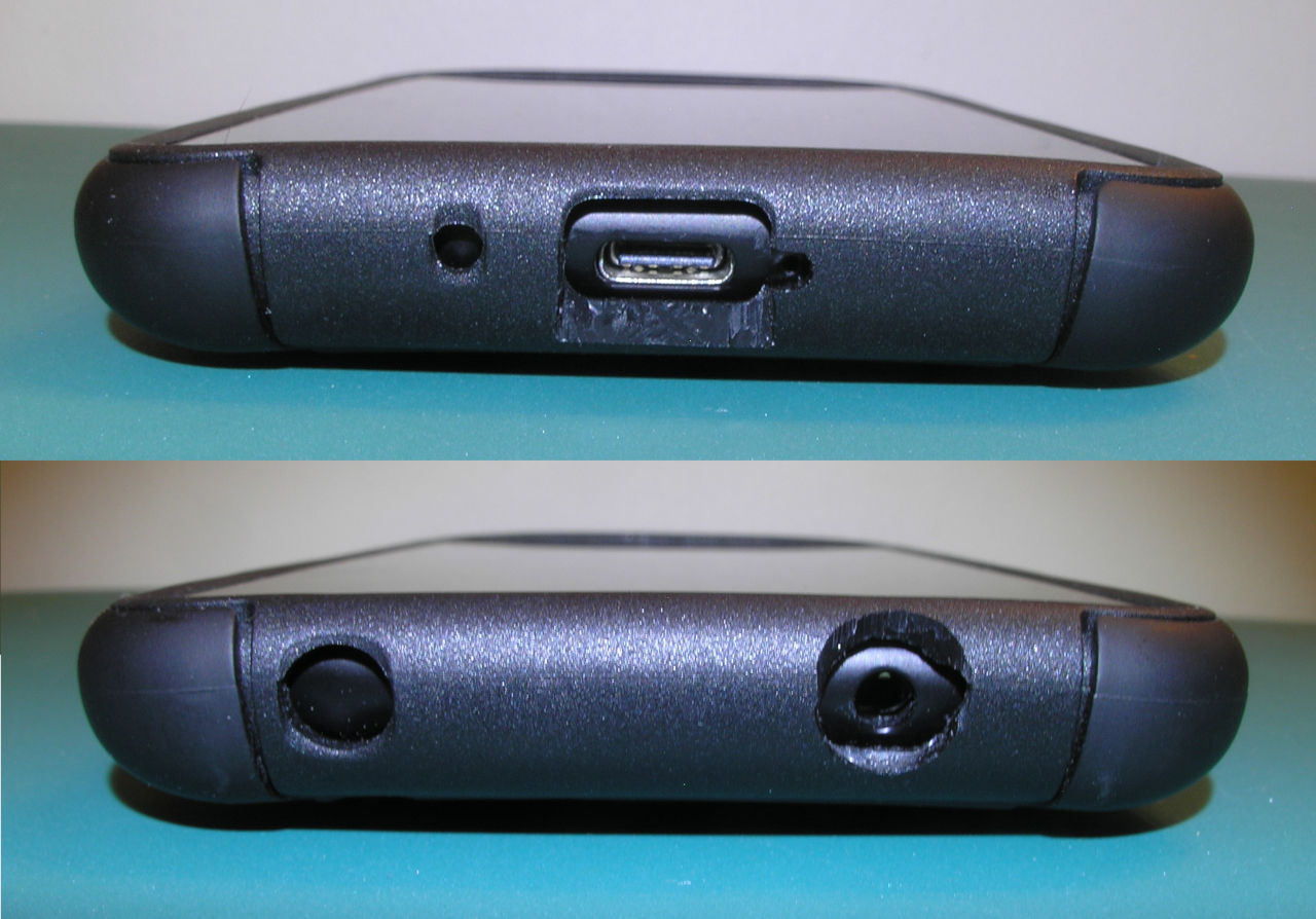

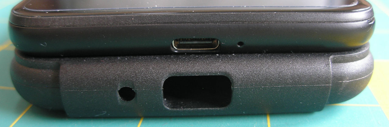

I probably made the headphone port access too big. Notice the negligible, if any, lip at the sides of the screen. Also notice how the hard shell corners seem bent, leaving a gap between the rubber.
Notice the different locations where the back planes begin curving to the front.
I think this case would have had a better screen lip on the phones it was designed for. The back of the PinePhone is predominantly planar, but it seems as though the back of the G7 Power probably starts curving towards the front considerably further away from the edge. While the G7 Power may have a depth of 9.4mm, the sides of the G7 Power are probably thinner than the PinePhone, thus the case material won't wrap as far towards the front of the PinePhone.
The shape difference is also likely responsible for the gaps between the hard shell and rubber at the ends. Additionally, the holster does not fit the assembled case & PinePhone. Lastly, the rather narrow button depressors may not be optimally centered (front to back) on the PinePhone buttons, and can slip to the side of a button. Fortunately, this only happened rarely, and can be fixed without disassembly by pulling the rubber edge outward away from the buttons.
