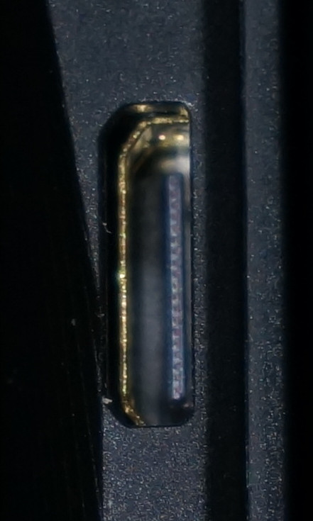

In my specific unit, plugging in the mini HDMI hole is not lined up with the port
.jpg   DSC07284.JPG (Size: 54.01 KB / Downloads: 692)
It's extremely tight, tight enough that Ill likely take a file to the case at some point.

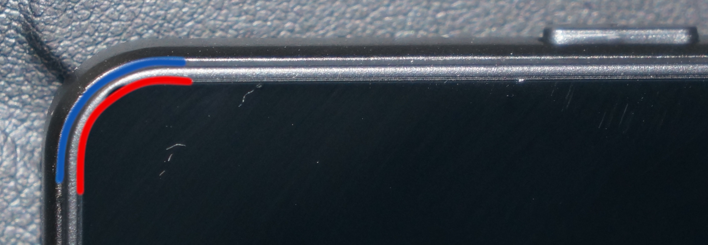

For those that wish to take apart the Pinetab.
.jpg   DSC07286.JPG (Size: 313.81 KB / Downloads: 779)
Follow the blue line with a plastic spudger, NOT the red line. Open from top to bottom, remove the top first. I found the top left (near the I/O) to be the easiest starting point. Be patient putting it back together, the bottom may not be easy to align.
