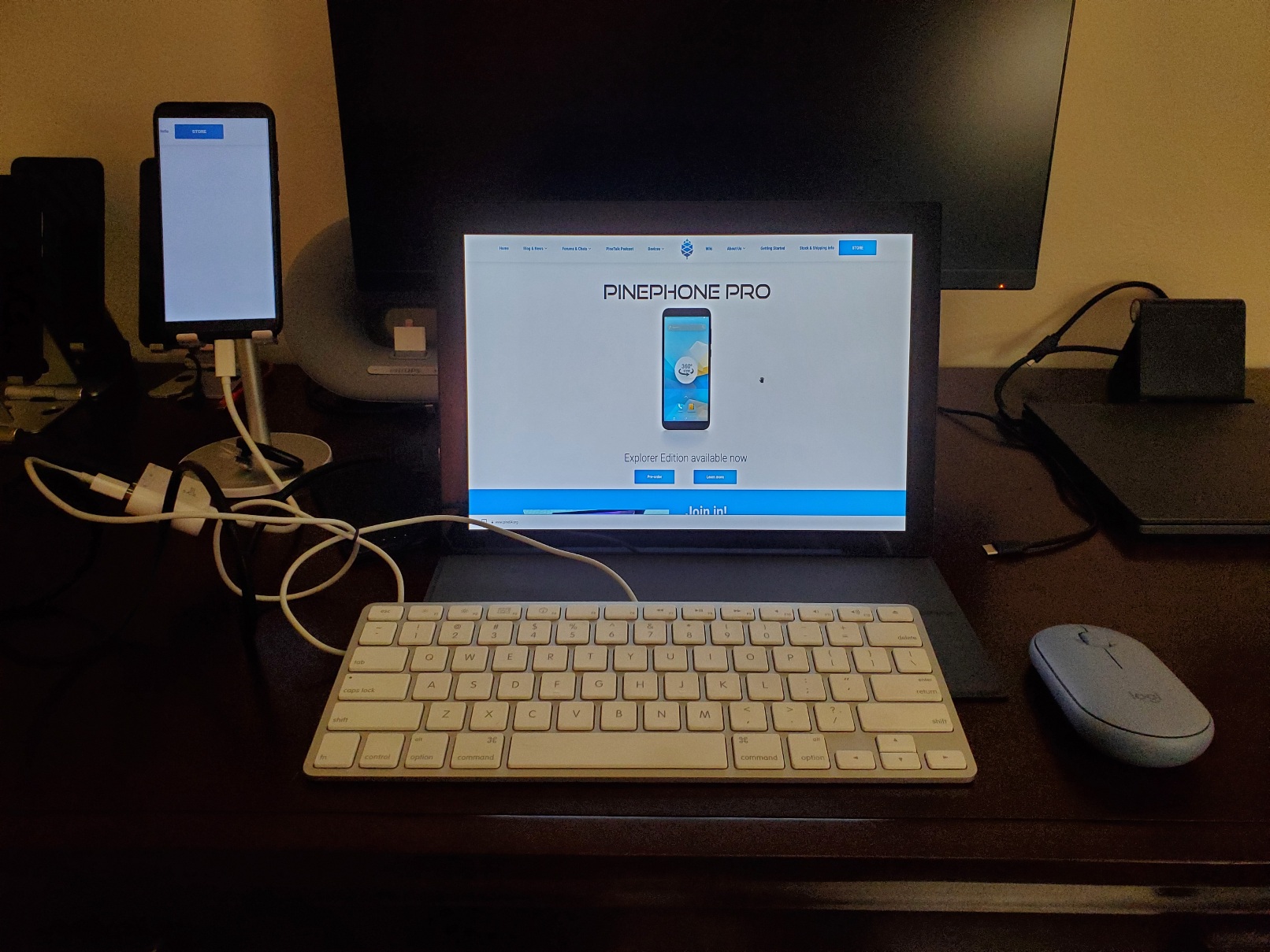

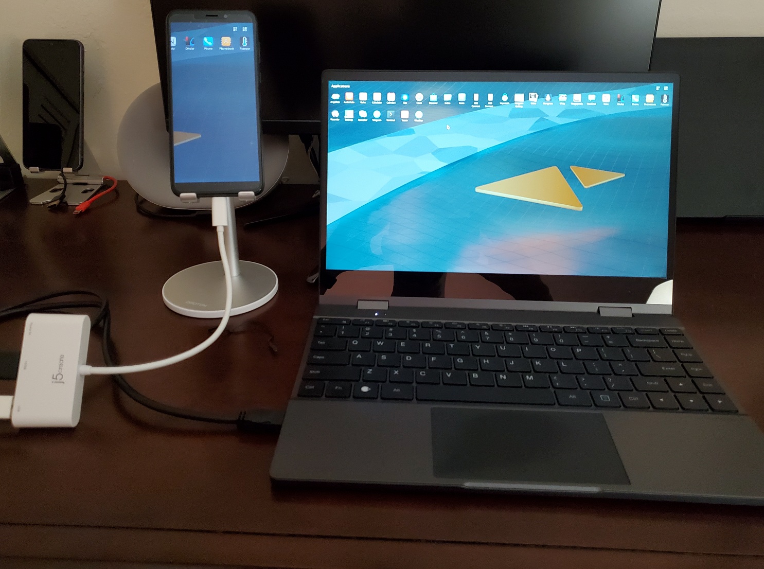

OK, I had a major breakthrough this morning. I realized that the site does not show or mention how the PPP is connected to the monitor displaying a working Desktop mode. I am also aware that the brand/type of USB-C/HDMI hub as well as the cables make a difference when using Desktop mode with most phones.
I have been using a j5create HDMI hub with an HDMI to HDMI cable out to a regular computer monitor, as well as plugging the phone into my NexDock 360 lapdock using a USB-C to USB-C cable that works with my other phones for video out (original Pinephone and a Galaxy S10). As mentioned previously, neither worked with the PPP.
I own a UPerfect 12.3" portable monitor with USB-C and Mini HDMI input. I connected the PPP to my j5create HDMI hub using an HDMI to mini HDMI cable to the UPerfect monitor. The monitor displayed the desktop version of the phone!
I then connected it to the Nexdock 360 using the j5create dock and mini HDMI input and it worked as well.
I know that video out does work, so far only using HDMI type cables (not USB-C input on the monitors), but at least with my configuration there are a few problems that will hopefully be fixed with software updates:
1. Whichever program you run fills the screen, and there is no way to exit the program using the keyboard and mouse, or the phone itself, so I disconnected the phone, closed the program and reconnected the phone. It would not display on the monitor. After several attempts at disconnecting and reconnecting cables, I finally got it to display again. But every time I disconnect the phone it takes several tries to get it to display on the monitor again, which eventually works. I am new to Linux, so there may be a way to close programs in Desktop mode that I am not aware of.
2. Sometimes a mouse, or the touchpad on the Nexdock 360 will not register on the phone. Again, hopefully a software update will fix that.
3. The phone displays its own desktop mode while connected, which is pretty useless from what I can tell. I couldn't see any info such as battery level or the time on either screen.
I am thrilled that this is working to any degree! A huge relief, and now I will be patient as amazing people continue to develop and contribute to this project.
I hope to eventually learn enough to be able to contribute as well.
Thanks.

The j5Create dock model that I am using is the JCA379 (Best Buy # 5930600).
The original Pinephone dock did not work for me, FYI.
Hopefully someone will find a dock that works consistently. As I mentioned, every time I disconnect from the dock it is trial and error unplugging and plugging different cables in different order to get it to work again. Don't give up!
Also, a standard HDMI cable with full size connectors did not work on the PPP for me between the j5Create dock and my Acer 24" monitor. Only a full size HDMI connector on the j5Create dock to mini HDMI input on the NexDock 360, or the UPerfect portable monitor. Try different cables if you have them as well.
Good luck!
