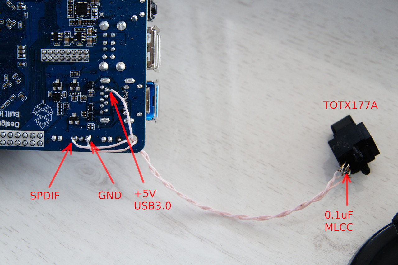

Just arrived. Now I'm looking for a plug that fits into the socket of the board and didn't find much information, yet.
About a connector. Look for 2mm-pitch crimped wire three circuits connector, for example.
Just to prove a concept, I took old but brand new TOTX177A transmitter with 5V supply requirement and done this way:
[Image: attachment.php?aid=1715]
P.S. letmegooglethat.com is just for fun, the question phrase actually is not obvious. Good luck!
.jpg   RockPro64_TOTX177A.JPG (Size: 251.65 KB / Downloads: 1,098)
Thanks, JST PHR-3 did it. I connected the transmitter already and it does emit light.

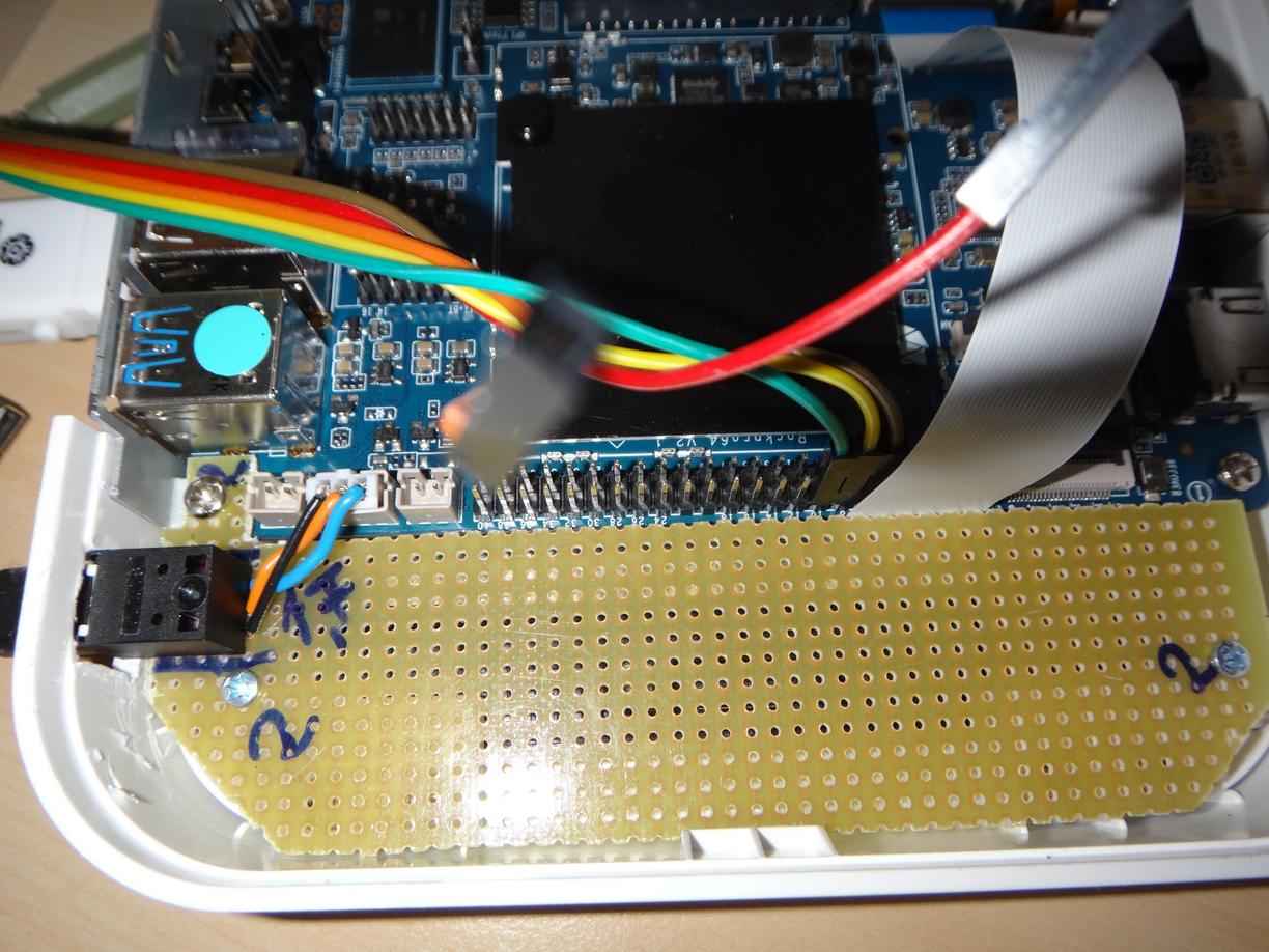

(04-04-2020, 11:24 AM)ChriChri Wrote: Did anybody successfully try yet the SPDIF output and if so using which software?
Works in armbian buster. It showed up as Sink #2 (alsa_output.platform-spdif-sound.stereo-fallback) and I could play sounds to it using paplay. Toslink connection works also Smile.
