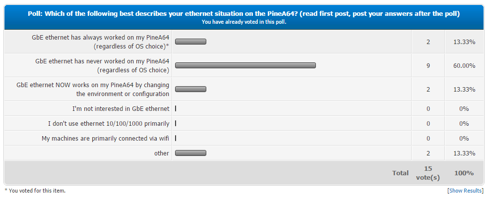

(08-24-2016, 11:34 PM)MarkHaysHarris777 Wrote: I built the poll.  I also edited the poll, to allow for multiple votes (2).
I know you created the poll.
So where on the attached screenshot of the poll does it allow me to vote a second time? Maybe you need to revist the settings in case it didn't actually apply.
You know what's happening (I think so) once you've taken the poll , you can't take it again.  So, if its the first time you can choose two options, but if you come back after only choosing one option... it won't let you take the poll again..
Sad
You know what's happening (I think so) once you've taken the poll, you can't take it again.  So, if its the first time you can choose two options, but if you come back after only choosing one option... it won't let you take the poll again..
Sad
Yup, since polls on MyBB are designed to only let you take them once (and not edited), so the vote can't be 'rigged'. And I took it before you modified it, so was only able to choose one option. Which is all I would have been able to pick anyway since my 2nd Pine64 is nowhere to be seen, so it wouldn't be fair to say it didn't work Wink
