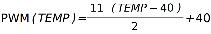

The PWM curve by Interpolated method is:

Right now you are with a Function like this:  Shy
So with a max temp of 60C, you will get 150 PWM.
