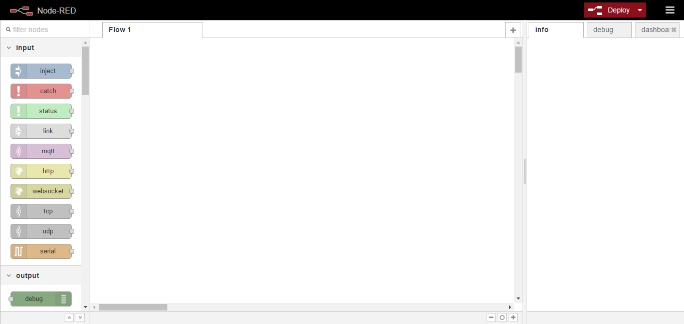

Node-RED
Node-RED is a tool for wiring together hardware devices, APIs and online services in new and interesting ways. It build on top of Nodejs
With this, PINE64 going to be more interesting.   Smile
Tested with PINE64 2GB(1GB and 512MB shall work well, anyone with this please help to test out), Debian Base(Others Debian built shall work well, some Debian only support Nodejs 4.x).

7) After all done, you will able to access node-red at browser (Default will use port 1880, can be update in settings.js)
http://[PINE64-IP-Address]:1880
8) Create a sample flow. You can import the this sample flow at Menu(Right Top Corner) -> Import -> Clipboard
