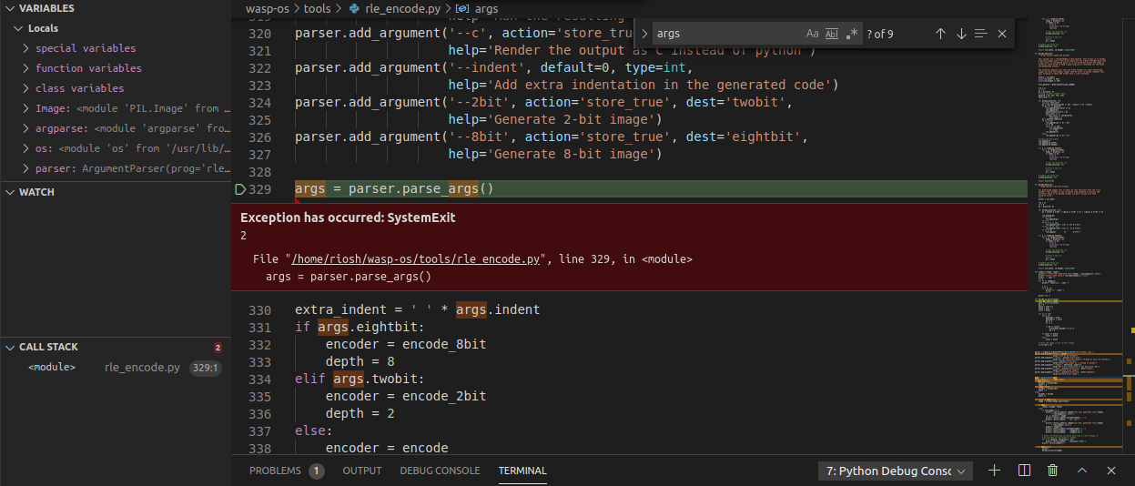

sir,
can you share some more details about rle_encode.py, am new to python, don't know how to use it. is there any tutorial or command to implement. how it will take the path of the image for conversion. i am being silly but i didn't got any information in internet. thank you for the help.

sir,
i got some exception error while debugging screenshot attached with this mail. how can i proceed converting into rle conversion.

It's a command line tool so you should just be able to run it and it will show the results (which can be redirected to a file to avoid having to copy 'n paste from the terminal):
./tools/rle_encode.py --help
./tools/rle_encode.py --2bit myimage.png > myimage.py
./tools/rle_encode.py --2bit image1.png image2.png image3.png > images.py

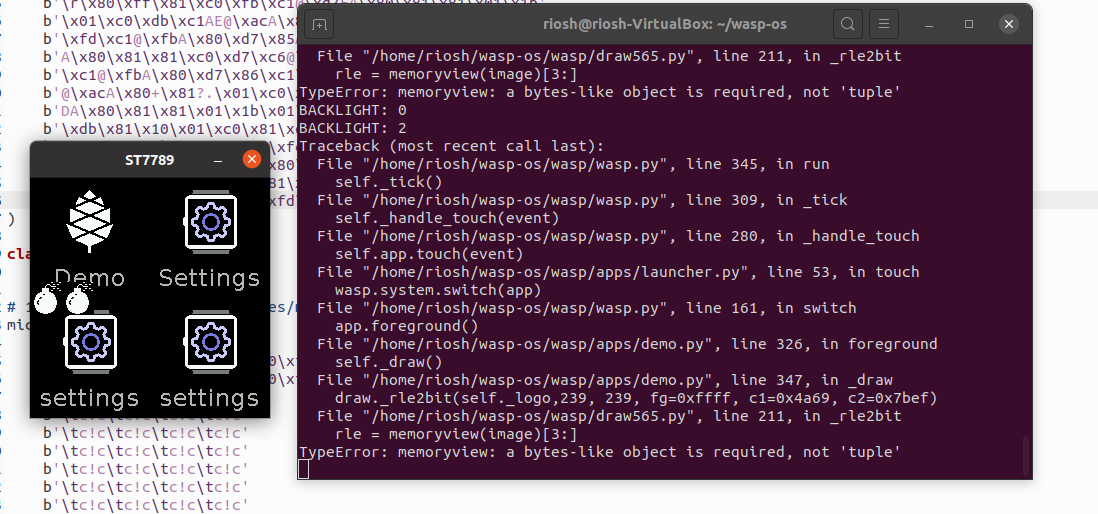

After conversion of image 240x240 pixels i tried to implement in the demoApp.py and tried to execute in simulator it crashes. i used this code:
draw._rle2bit(self._logo,20, 20, fg=0xffff, c1=0x4a69, c2=0x7bef)
what could be the reason. i attached the screenshot with this message.
if u can share to convert 1-bit rle. It would be helpful.
thank you.
.png   Screenshot from 2020-07-10 17-27-35.png (Size: 163.11 KB / Downloads: 540)
.png   Screenshot from 2020-07-10 17-37-28.png (Size: 146.41 KB / Downloads: 546)
I can see a couple of things here.
Firstly you are calling the private draw method _rle2bit() rather than the documented blit() method (see https://wasp-os.readthedocs.io/en/latest...ml#drawing ). Additionally you have supplied fg, c1 and c2 arguments instead of relying on their default values.
Secondly you are blitting a full screen image at (x,y) = (20, 20). This will drawing outside the bounds of the display and that provokes an exception.
Try something simpler such as:
draw.blit(self._logo, 0, 0)
One reason to prefer Draw565.blit() over Draw565._rle2bit() is that the code above should work, without modification for 1-bit images as well.
