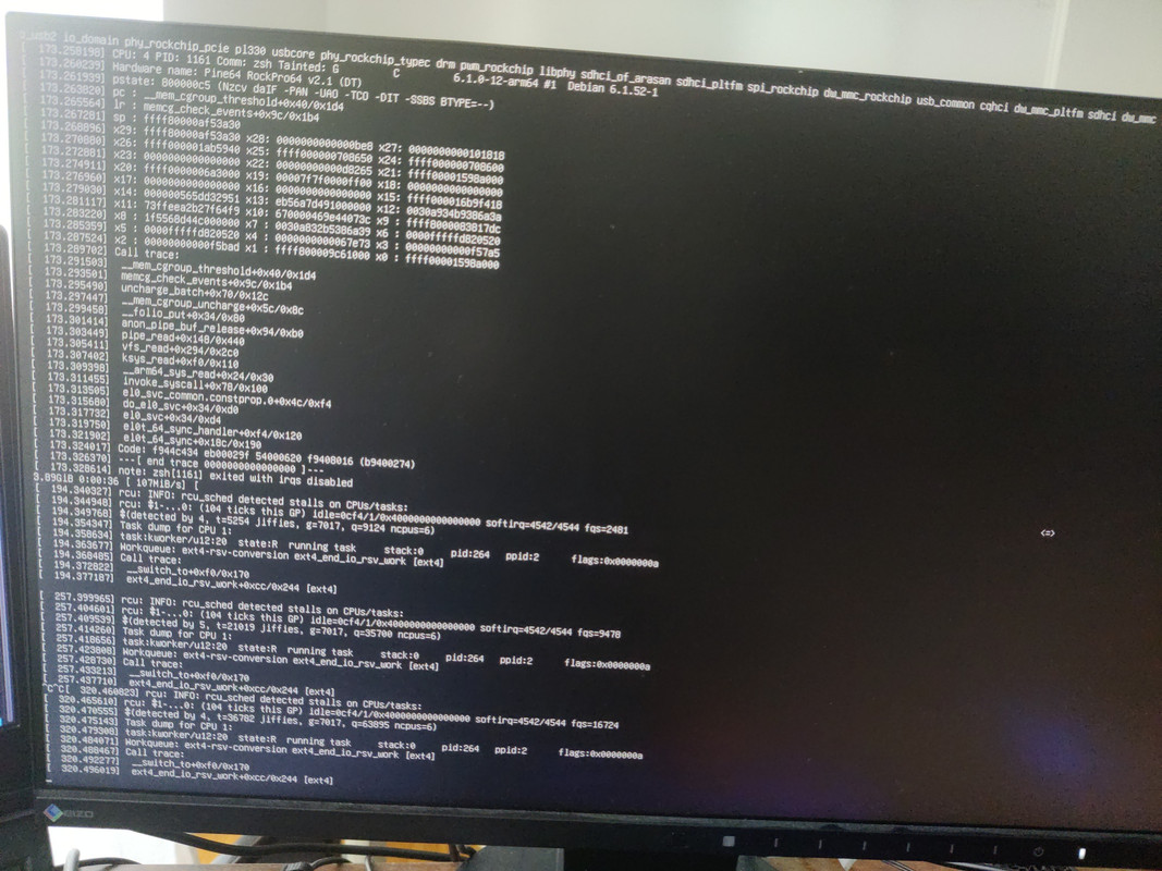

Another interesting crash happened while testing today: after throwing an "Oops", the kmsg logged "rcu_sched detected stalls on CPUs/tasks: ... Task dump for CPU 1..."
See this picture for the full log.
Here, the system did not freeze up entirely but was not usable either.
