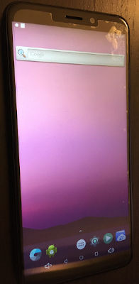

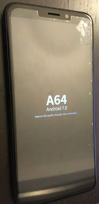

(02-08-2020, 11:56 PM)edge Wrote: The device is a bit larger than expected and the modem unit on the back is positioned well for a semi-transparent case along the lines of LG Fx0.
For software, are there any special steps for getting to the factory test app? Huh On boot, the device shows a splash screen for A64 Android 7.0 and loads Android in Chinese with popping noises from the speaker. pmOS loaded on external media does boot as expected.
That doesn't sound right? From what I've read, and my own experience, the internal flash should've been loaded with the factory test app.

In that case, is the factory test image available for loading onto external media? Testing hardware functionality through the dedicated app would be helpful.
Attached are photos of the boot screen and home screen.

#54
(02-12-2020, 11:59 PM)edge Wrote: In that case, is the factory test image available for loading onto external media? Testing hardware functionality through the dedicated app would be helpful.
(Edit was to actually add attachments.)
Yes - it is one of the demo images available for postmarketOS.
I should add that although most Brave Heart recipients are dutifully booting this test image, it is my understanding that apart from booting and displaying a screen it really doesn't do much in terms of thorough testing. It was a quick and nasty (I hope I am not being too unfair) solution to ensure the Brave Heart phones booted rather than just lay there when they were switched on out of the box!
