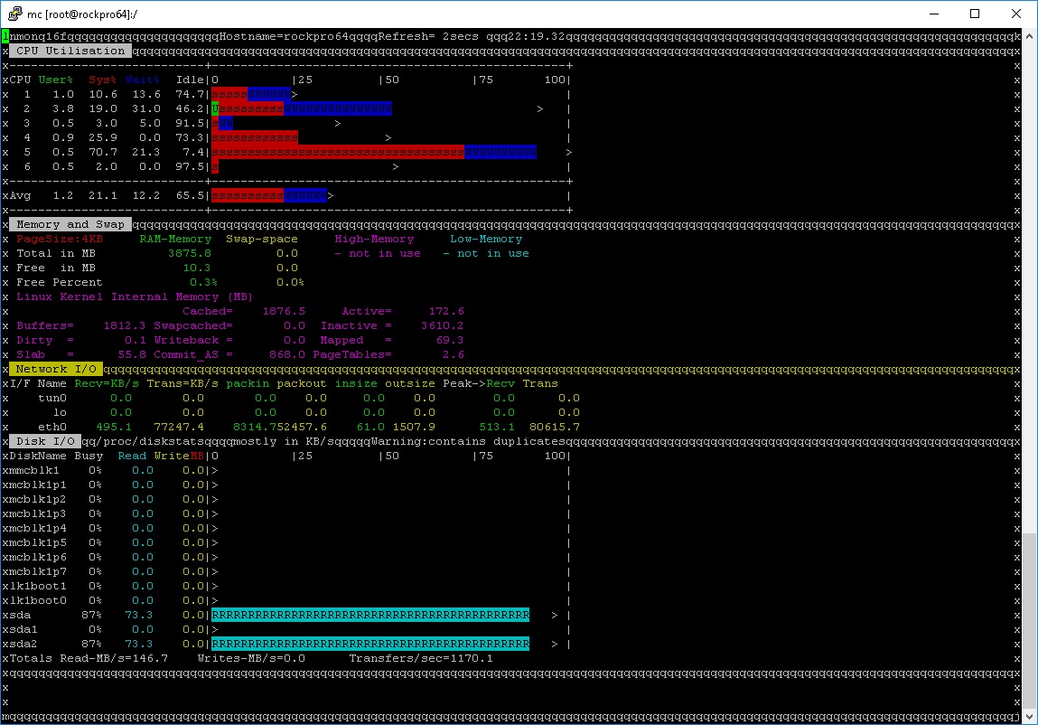

in the case, chassis fan is not connected yet, heatsink 30mm with fan, in the room there is no air conditioning, immobile air, air temperature +25С
My board in SOHO NAS server mode, Samba/NFS/Apache/MySQL/Transmission/OpenVPN,
for a personal internet site, torrent download, Veeam backup of three computers, local network video playback, Remote access to the local network.
the second day I observe a temperature of +39...+ 42C

During the backup it behaves like this:

P.S.: -- set a Ratio to PWM:
MAX_THERMAL_TEMP = 50
MIN_THERMAL_TEMP = 40
These are the maximum values that I have seen, at the moment, the Casing temperature reaches +37С
By the way, I did not use a thermal conductive silicone pad, from the heatsink kit,
between the microcontroller and the heatsink only thermal grease.
I plan to install a thermostat on the basis of DS1821 (in thermostat mode),
connecting to it the exhaust fan of the casing,
the hysteresis of which will be 5 degrees Celsius, shutdown +32C, switching-on of +37C,
which at the physical level will protect the heatsink overheating,
in cases of failure of the fan on the heatsink.

Temperature during backup, while working with 8:00:00 to 8:09:15 :

P.S.: chassis fan Speed: 2400RPM, Air Flow: 25.15 CFM, thermostat - shutdown <= +32C, switching-on of >= +37C
heatsink 30mm with fan -- set a Ratio to PWM:
I install an exhaust fan in the chassis, fan Speed: 3500RPM, Air Flow: 42.83 CFM (on 17.68 CFM more)
On average, the chassis fan switching-on of 1.5 minutes, then 10 minutes shutdown and so on the cycle,
for example, the time of the switching-on of fan is accurately recorded: 07:17, 07:24, 07:40, 07:54, 08:04, 08:13, 08:21, 08:30, 08:47,
backup time 08:00 - 08:22, 08:30 - 08:40
one day logs file attached:
temperature.zip (Size: 69.24 KB / Downloads: 287)
my SOHO NAS RockPro64 4GB v2.1 / eMMC 32GB / PCIe -> 4*SATA Marvell 88SE9235 / SD-card 64 GB / NAS Casing / image Debian Stretch Minimal / Kernel 4.4.xxx ayufan
