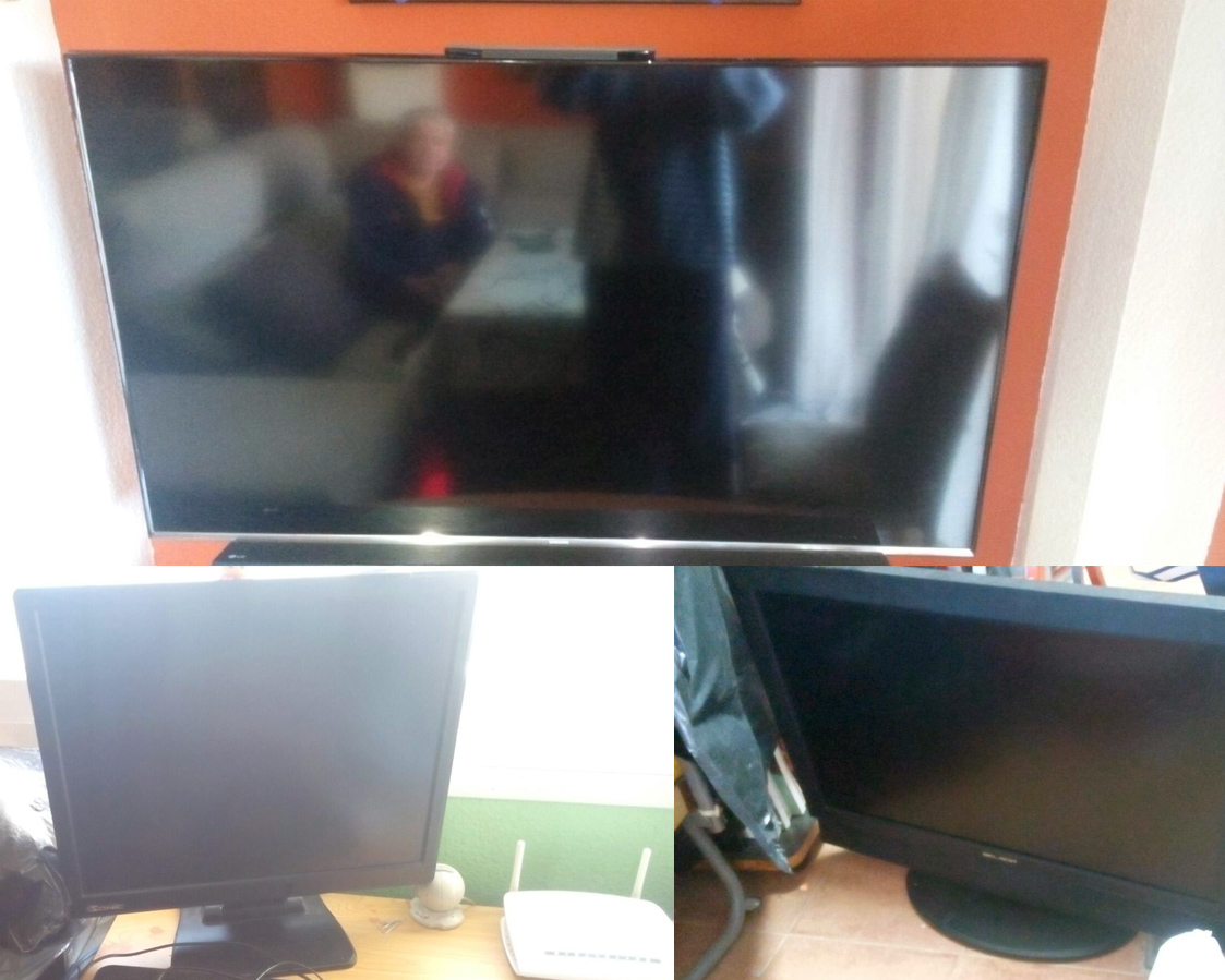

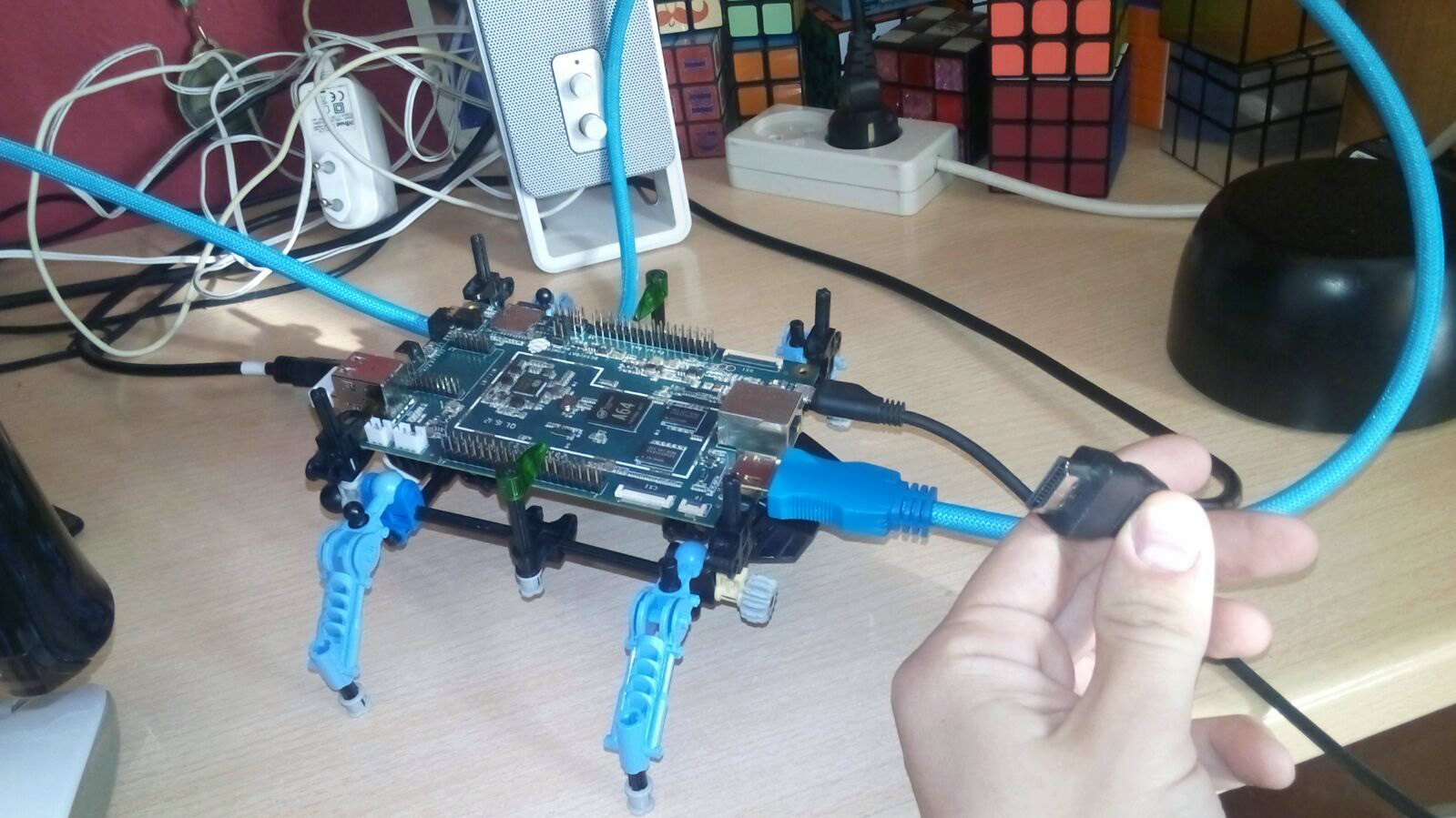

It turns out that from the first moment you try to connect pine64 to a monitor HDMI with a direct cable but did not give signal.

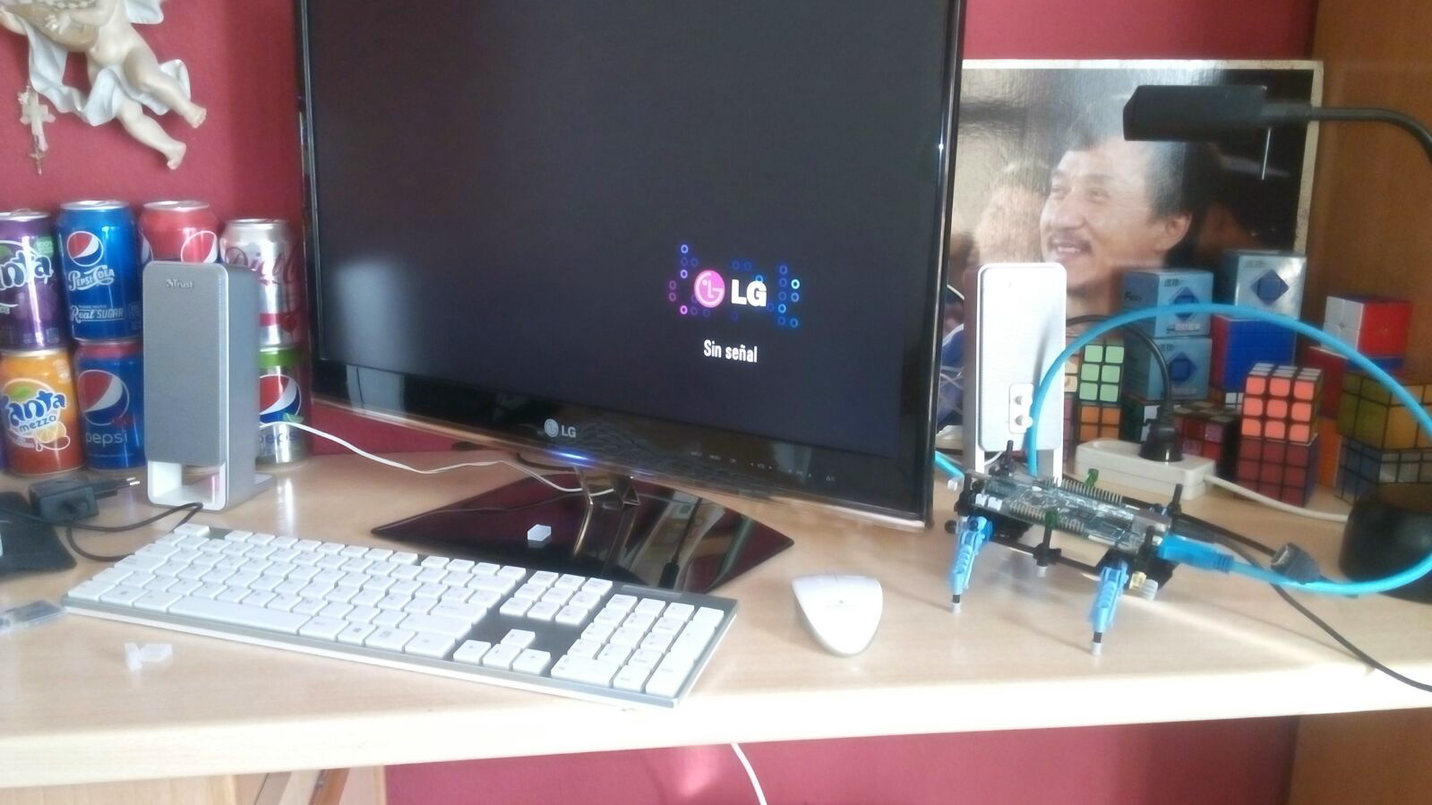

I was reading and saw that it was taking a bit of trouble Pine64 with this, for I well, tried several cables, various types more expensive, cheaper and with a total of 4 TV's and monitors of different brands and generations with direct connection hdmi making all possible combinations and I have not gotten even see the welcome screen pine64.
Am I doing something wrong ?, or is it a possibility that is defective? please if someone has happened something similar would welcome help.
