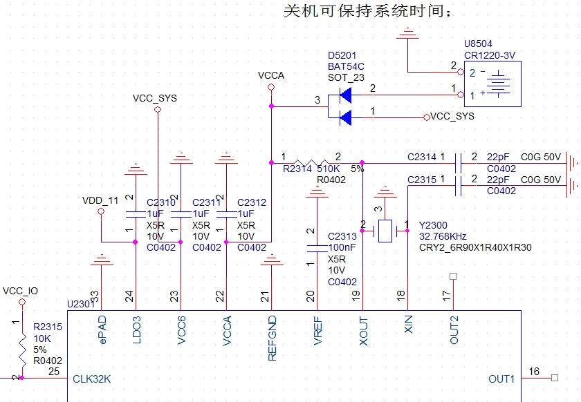

could we  add ourself with soldering iron for current version
(09-11-2017, 01:25 AM)listenfree Wrote:
(09-07-2017, 12:10 PM)tllim Wrote:
(09-07-2017, 02:32 AM)mbc28 Wrote: Great! Do you have any estimated date for the next board version?
December 2017, add in RTC Battery option is the only revised item.
Attached is the schematic is you interest to try out. However, it is not an easy task due to power plane involved.
