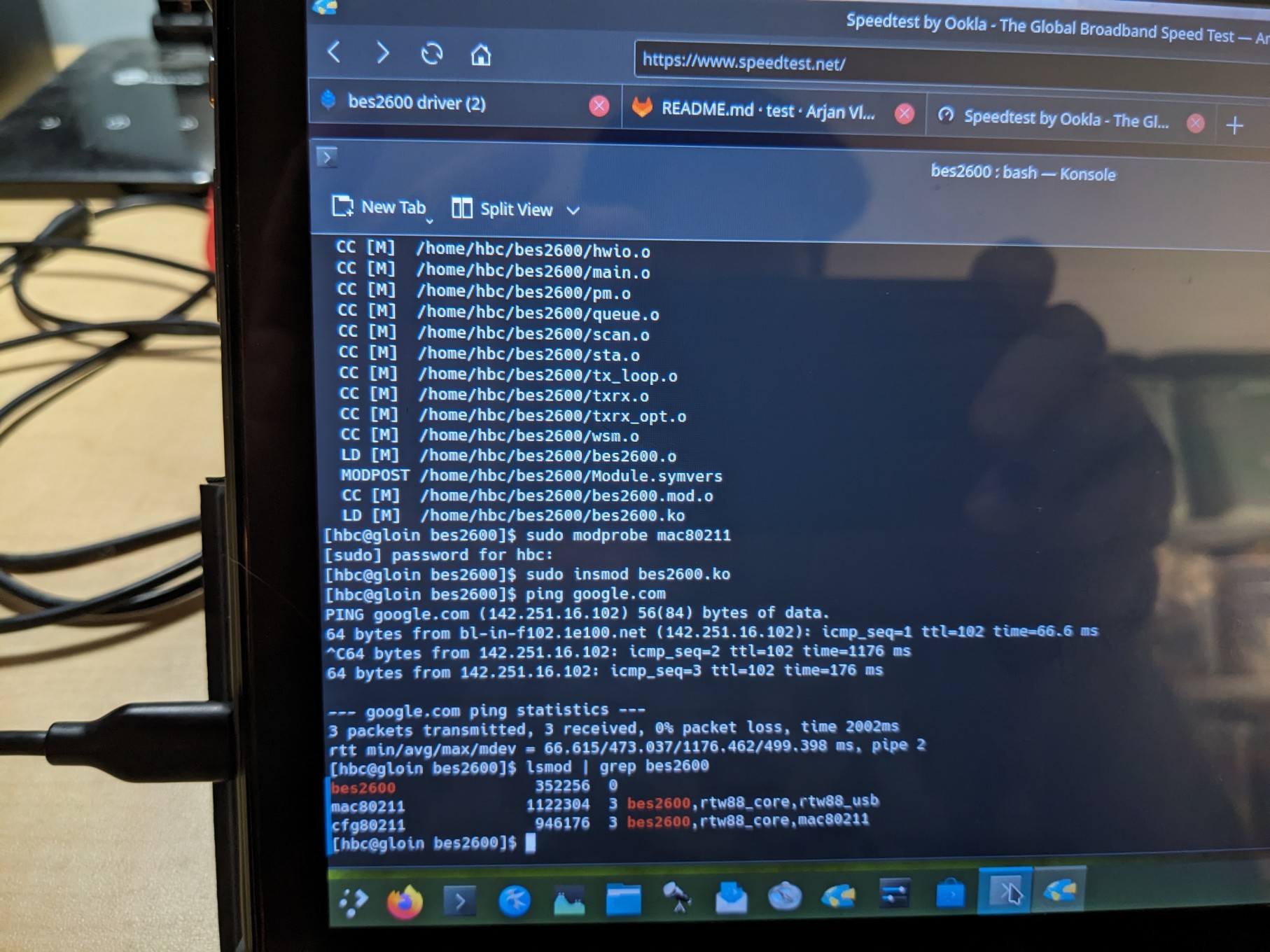

It works!  Well, mostly.  Pics attached.  Thanks to Arjan, Segfault, and everyone else involved with this.  A couple of caveats for anyone else that wants to try it out:
1) The list of build tools in step 1.1 returned some errors for me, as the files weren't found.  I made some substitutions:
xz for xz-utils
libssl for libssl-dev
libelf for libelf-dev
ncurses for ncurses-dev
Some of these were already installed, and some (maybe even all) may not have been necessary.  I wasn't sure if they were part of the reason I was able to do a successful build though, so I thought I'd mention them.
2) The firmware comes in a subfolder called bes2600.  The actual driver also unpacks to a folder called bes2600.  Be careful not to confuse them, or write both their contents to the same folder.
Yes, it's slow.  My speed test actually had the upload a little faster than the download.  It causes the tablet not to come out of suspend, and the driver crashes when I go to shut it down.  Great progress though!
