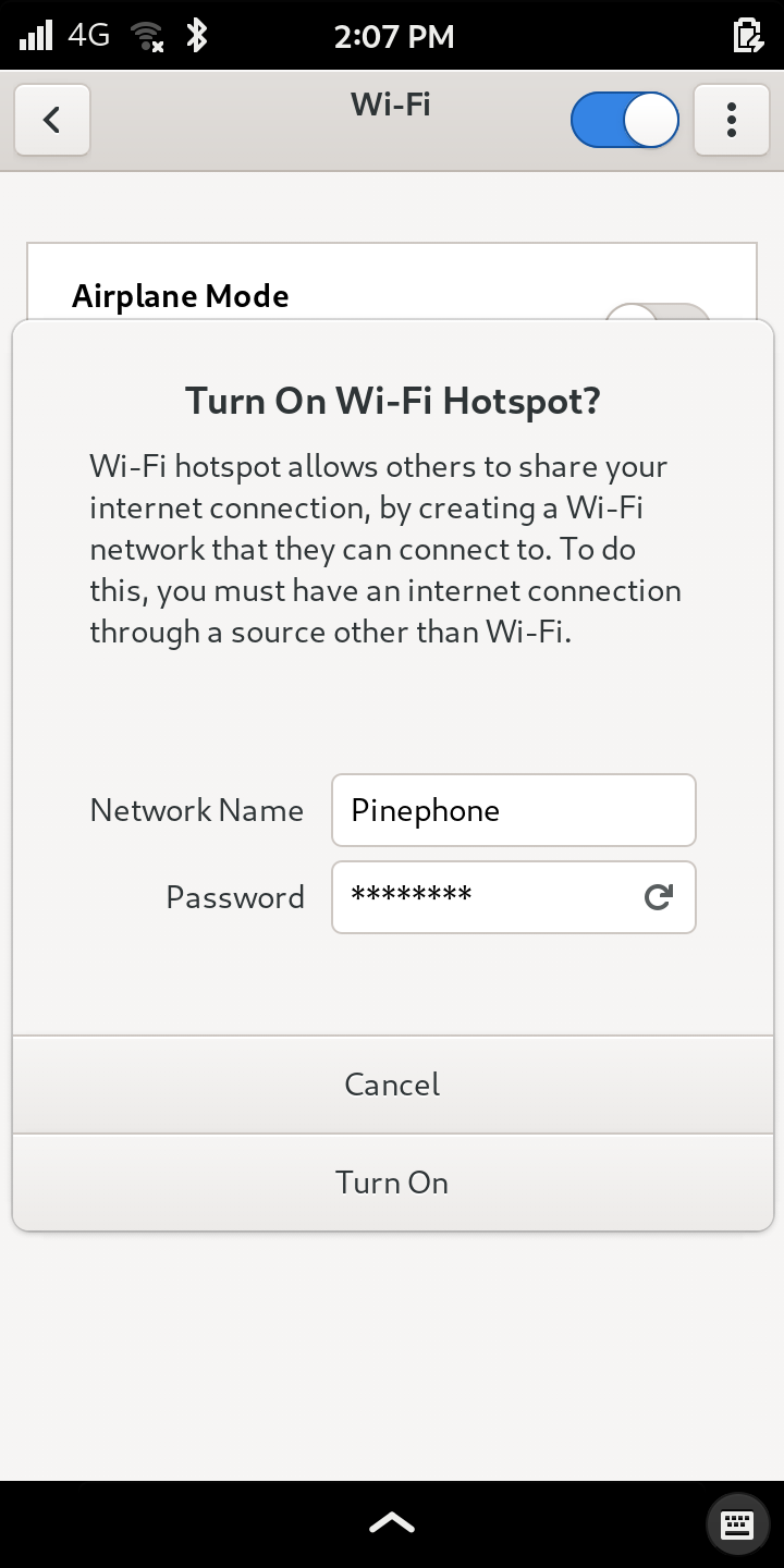

1. YES
2. YES, no MMS
3. YES. I have to turn on the Bluetooth to see the hot spot
4. YES
5. YES, but it needs more work.

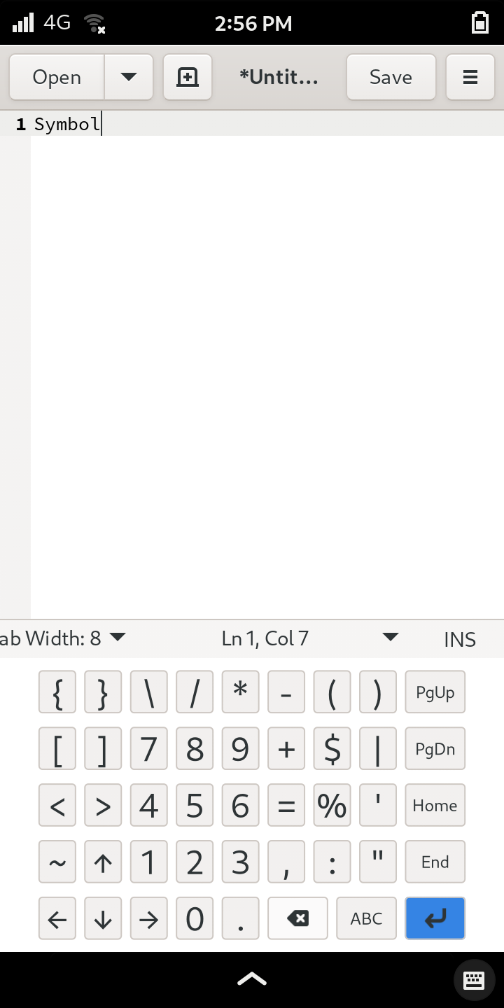

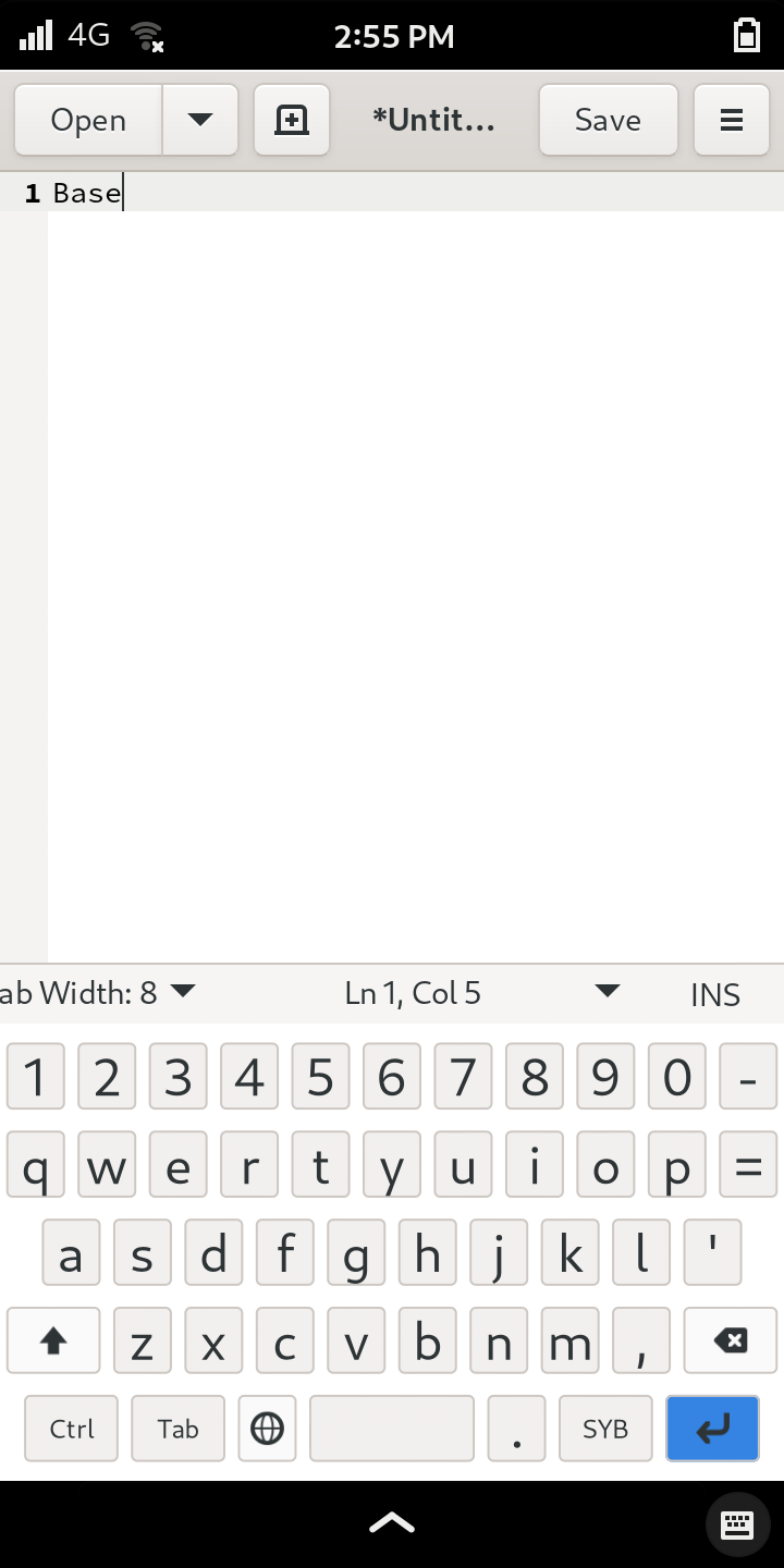

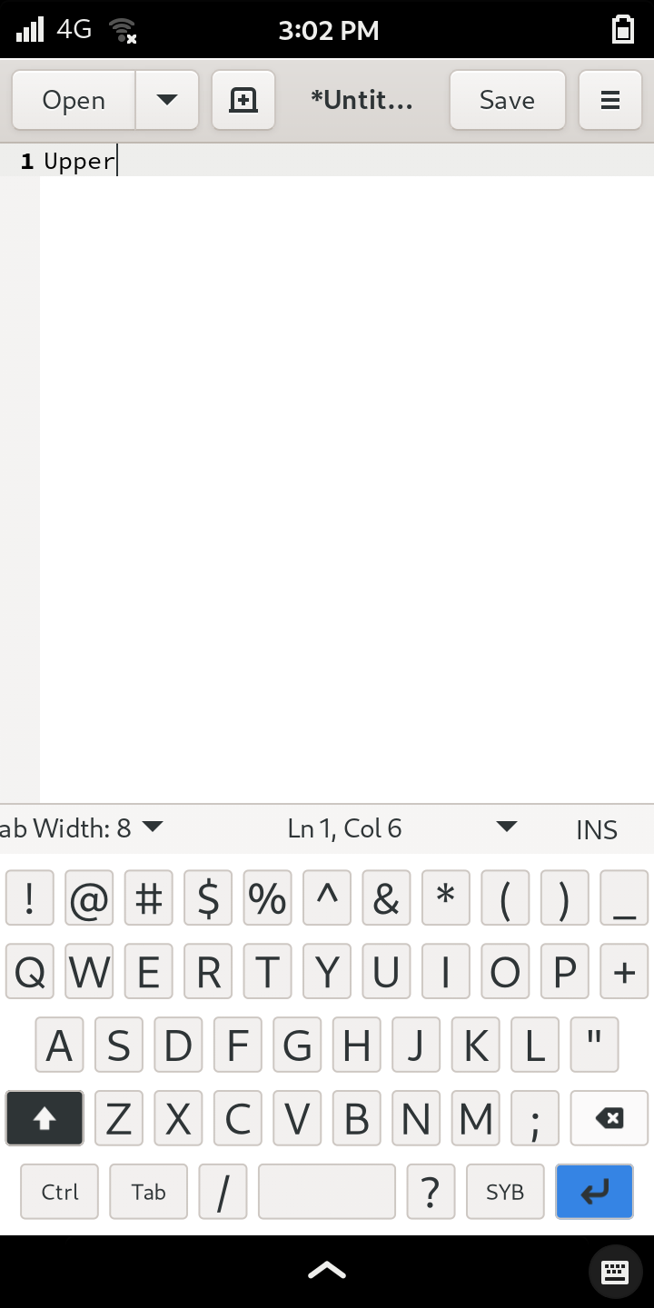

I started with Jumpdrive to expose the eMMC and flashed the latest Arch release. So my OS is rolling Arch and Phosh.
1. Update the whole system with "sudo pacman -Syyu"
2. Connected my Go ogle account for contacts email and calendar
3. Created a custom keyboard layout.
4. Installed pcmanfm "sudo pacman -S pcmanfm"
