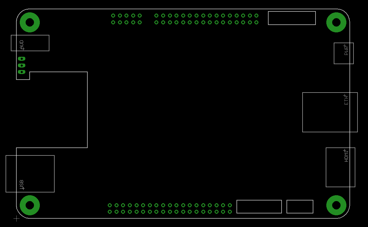

Hi All
I started working on an Cadsoft Eagle LBR so I can develop a few POTs:  (like started 10 mins ago)
I couldnt find a mechanical drawing of the Pine64, so this is all verniered out... / eyed out ....
WIP... Will update here as I make progress - any help appreciated
https://github.com/openhardwarecoza/eagl...64-hat.lbr

good initiative Smile
Nice work!
I don't have any calipers, so the boards I built are only hanging on by the PI 2 connector.
Any chance you could add dimensions to your drawing?
I'm sure I'm going to do more boards in the future, and I'd be great if they actually fit better.
Thanks I must have totally missed this, I'm going to check and measure and they maybe just mill one out for fitting tests...
