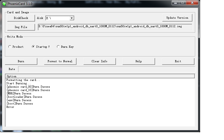

Tried to burn the android image onto my sdcard but fails every time.
Phoenixcard is running as administrator.
Reformatted sdcard a few times still no luck.

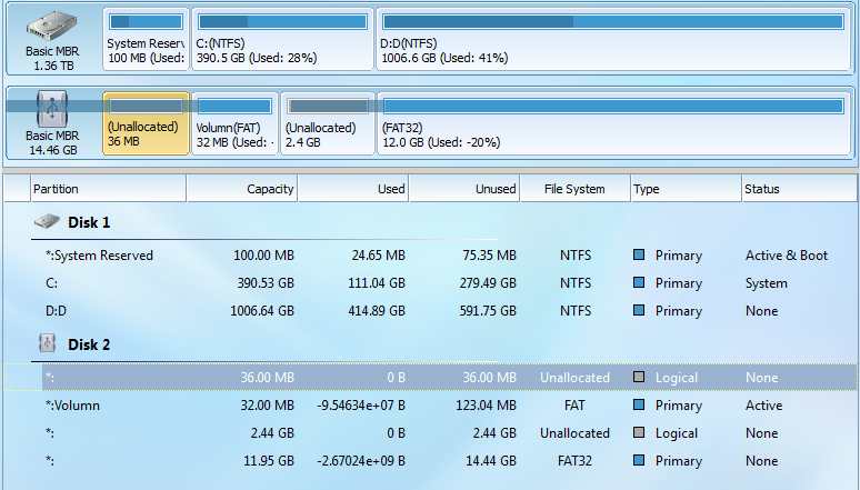

The partition of the sdcard after phoenixcard reformatted it seems very weird.
Attached the images of error for reference.

  • He used a genuine Samsung EVO and not a fake card (with counterfeit cards that fake a larger capacity using Phoenix Card you'll always already fail after the '[boot]Burn success' message since Phoenix Card will then try to write to the system partition that is beyond the card's real capacity. Phoenix Card always expands the partition scheme to the maximum and the largest partition is a data partition in the middle. So using Phoenix Card you can already spot fake cards)

Apparently , phoenixcard cant work with the sdcard-usb readers.
Fixed it by using the sdadapter.
Remix running well now.
Thanks guys.
(04-18-2016, 05:58 AM)Nova136 Wrote: Apparently , phoenixcard cant work with the sdcard-usb readers.
WRONG! Phoenix Card is interface agnostic!
You just ignored issue N° 2 from the list of the most common reasons why Pine64 won't boot: http://forum.pine64.org/showthread.php?tid=514
Your USB reader corrupted data while writing to the card and Phoenix Card was able to detect that. If you would have tried to burn a Linux image, burning would have suceeded but Linux would have crashed later. What to do: Always use H2testw or f3 first. It's so easy and nobody does it.

I will only comment on this Phoenix Card behaviour and add a link to one of the many problems related to USB card readers on high speed ports: Overheating paired with data corruption. And it's as easy as always to detect that using h2testw and/or f3.
Phoenix Card in Startup mode first partitions the card and then tries to write specific blocks of data to the card (that are not necessarily inside partitions, for example the bootloader and env stuff is just a few sectors at the beginning even before the partition table itself). Phoenix Card uses a rather primitive checksum algorithm to verify some of the written data. But at least this checksumming succeeds most of the times in detecting both data corruption and counterfeit cards (since the system partition is located beyond the card's real capacity).
Anyway: the technical background is close to irrelevant if people would simply learn to use h2testw or f3 first to check both card and burning process. If Phoenix Card or WinDiskImager will fail, those two test tools will fail for sure and also show the reason.

And I think if Phoenix Card would not only spit out "Error" but "Checksum error" instead when it detects exactly that it would also help. But since this is Allwinner's software I don't think they'll improve it since most Allwinner devices are factory flashed (tablets and OTT boxes with internal NAND/eMMC) and they even might not be able to imagine in which trouble users get when having to rely on this software.
So still using h2testw and f3 is the best option. Since they're also able to disclose problems related to the burning process in question (the USB reader that overheats, the USB front ports that lead to data corruption due to unshielded cables and so on)
