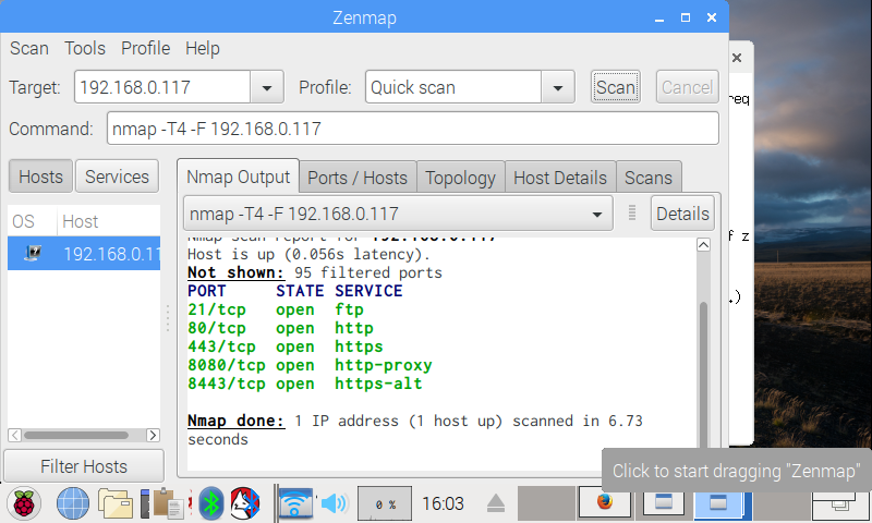

I got a lease, and an IP.  Sort of.  Still can't ping the AP/router, or www.google.com.  BUT oddly enough I can get back in.  On a phone I scanned my subnet and saw it.  So I FTPed a file out as a test.  Then I started wondering what was open so I port scanned it with Zenmap on my portable Pi.
I get "destination host unreachable" trying to get out of the Rock but I can reach in.  Sounds like a netmask problem to me but I don't know where it would be.
