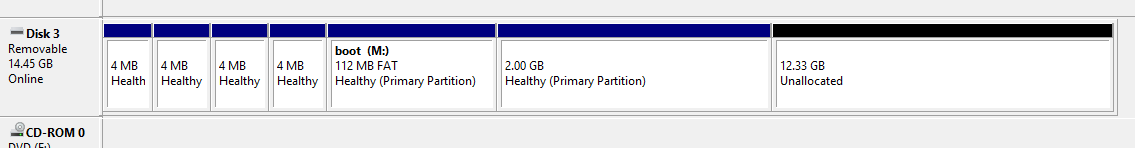

eMMC errors - MrFawlty - 03-02-2018 I am trying to setup Openmediavault onto my newly purchased Rock64. I bought the USB eMMC adaptor to ease installations and I can write the image with no errors using the Pine64 Etcher application, but when I insert it and turn on my Rock64, I get the errors in the attached image (Sorry, I don't have any other way to capture it other than taking a picture with my phone.) I have tried the following:
N00b question alert: The jumper on the board is only to be used IF you want to boot from SD Card, correct? You leave it open if you want to boot from eMMC? Thanks in advance. Daniel RE: eMMC errors - MrFawlty - 03-02-2018 I have just tried using the main Etcher program - no difference. I also tried writing the eMMC on a USB2 port instead of USB3, just to eliminate that. Could it be I have a faulty eMMC module? RE: eMMC errors - evilbunny - 03-02-2018 (03-02-2018, 02:36 PM)MrFawlty Wrote: I am trying to setup Openmediavault onto my newly purchased Rock64. I bought the USB eMMC adaptor to ease installations and I can write the image with no errors using the Pine64 Etcher application, but when I insert it and turn on my Rock64, I get the errors in the attached image (Sorry, I don't have any other way to capture it other than taking a picture with my phone.) Which image are you using, some 0.6.x versions had broken emmc support. Yes, the jumped disables emmc. RE: eMMC errors - MrFawlty - 03-03-2018 I just used the installer, so version 0.5.15-136 RE: eMMC errors - evilbunny - 03-03-2018 (03-03-2018, 08:11 PM)MrFawlty Wrote: I just used the installer, so version 0.5.15-136 Are you able to mount and inspect the emmc card from a computer, either running linux or a live boot CD? RE: eMMC errors - MrFawlty - 03-03-2018 Yes. I get 6 "You need to Format this disc" pop-ups when I insert on my Windows PC (I don't have a Linux PC running). I have attached what Disk Management reports. I can browse through to one of the partitions. All the others are reported as 'Unformatted' Well, this is weird. I pressed the reset button to see if that worked - no changes on the first 2 attempts but on the 3rd - it works! It booted into Openmediavault and I can set it up. I'll report back once i try turning it off and on a few times. RE: eMMC errors - Mentaluproar - 03-28-2018 I'm getting this problem too, both 32 and 64 bit builds. If you boot from SD, does your networking work? I'm wondering if we have the same problem. RE: eMMC errors - da_guy2 - 04-01-2018 I HAVE A SOLUTION! Had this exact problem and was beating my head against the wall for 3 days trying to get it to go. Eventually, I stumbled on this thread. https://forum.pine64.org/showthread.php?tid=5622 Turns out there's a bug with eMMC in the "Stable" version of openmediavault linked from the wiki page. In order to use eMMC you need to be on the latest (pre-release) version which is linked here https://github.com/ayufan-rock64/linux-build/releases One thing I noticed is they don't have an SD to eMMC version so to use it you'll need to have an eMMC adapter to connect to your PC. Could someone from PINE64 please update the wiki! RE: eMMC errors - tllim - 04-02-2018 (04-01-2018, 08:45 PM)da_guy2 Wrote: I HAVE A SOLUTION! We will put a note on the Wiki page. Once the next ayufan next "Stable" build released, we will revise back to use "Stable" release. |
