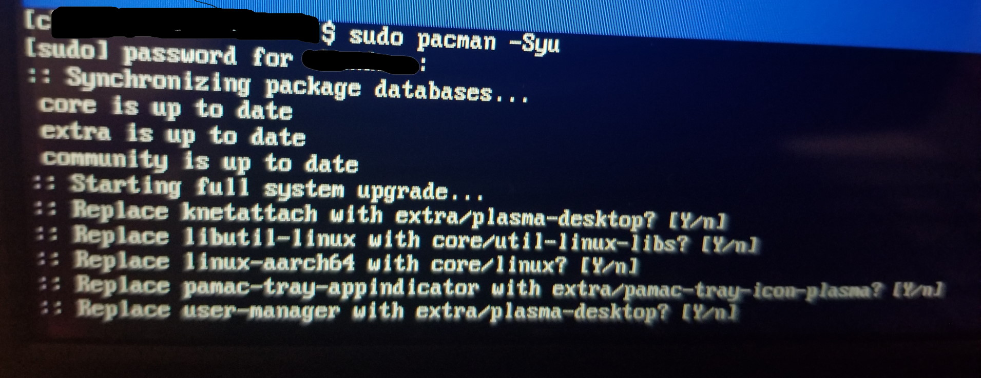

Just got my Pinebook Pro. Used it for a while and now won't finish booting in to Monjaro. Just a cursor in the top left. I can ctrl-f4 and it kicks to a command line prompt. Is there a way to just reset the system back to initial factory?
I tried to do a sudo pacman -Syu and chose no for most of the update questions. Any issues with accepting the defaults of this with a new system?

It prompted to use library's in different locations and make changes. I usually use Debian and I am familiar with apt-get haven't used pacman in some time. When prompted like this I didn't know if it was a Manjaro update or something specific to the Pinebook setup that would break functionality of the Pinebook. So I chose no when prompted to use alternate library paths.

[attachment=2328 Wrote:wdt pid='94077' dateline='1620230391']>It prompted to use library's in different locations and make changes.
I'm guessing you mean different repositories?????
If so, this means no network
Check,,,ip a
Then,,,, nmtui
I really hosed my sd card boot a week ago, had to go thru this and more
Usually pacman -Syu is the main recovery method
Not different repositories. Image attached.
nmtui worked great. I could activate the network connectivity and ran pacman -Syu. I chose Y for all the suggestions and once complete it still boots and just has a cursor flashing in the upper left. Never gets in to Manjaro.
