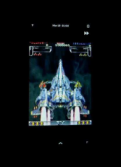

If you want to drain that battery a bit faster, you can run some games via retroarch - here's a low res video demo.
.jpg   pinephone-retroarch.jpg (Size: 26.19 KB / Downloads: 614)
