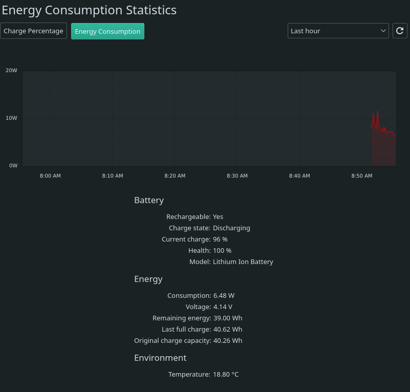

EDIT: So I was wrong. There is some Power stats available to me in this image. Here's what Power Statistics showed me for the battery:
[Image: WQcNlH0.png]
