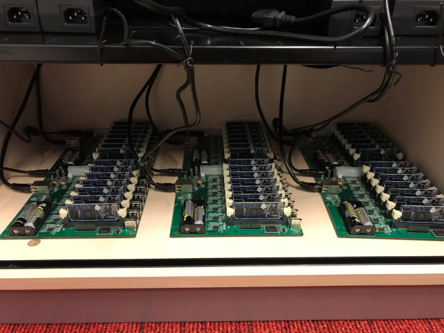

* Speedstepping
* Thermal sensor
* DMA
* SRAM Controller (ETH-PHY)
* PXE fixes (EFI bootloader patch)
* u-boot fixed for a couple of things.
* Almost complete - working devicetree.
I don't use SD, MMC, GPU, I2C, SPI or USB because this cluster is for another project
We currently have 42 sopines so making FreeBSD run perfect is one of my top priorities... haha..  Cool
