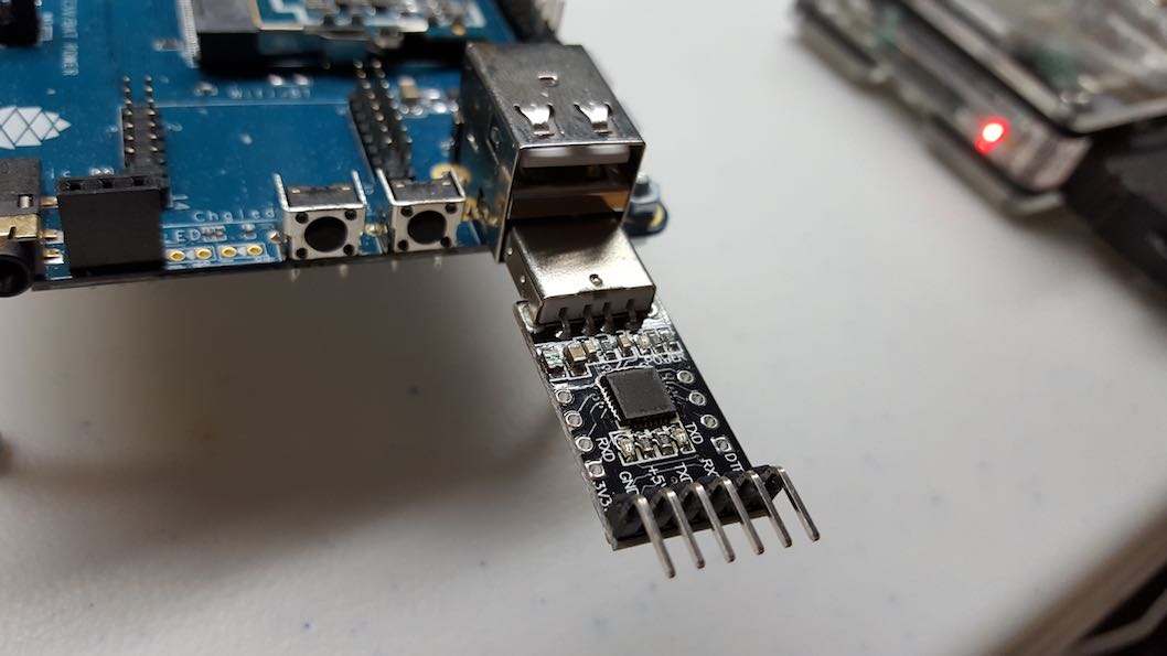

hi , get yourself one of these serial debug cables from ada fruit.
...  it is a PL2303 based serial ttl to usb bridge that you plug into the uart0 port on the PineA64 board, and then plug the usb cable into your gnu+linux pc, or other too.  You can then monitor the serial console during boot-up.  The white wire goes to pin(7) of the EXP header, the green wire goes to pin(8), and the black wire goes to pin(9).
DO NOT plug the red wire into anything !
These cables are indispensable for finding out what is going on during boot-up...

An adapter like this one will do just as well... you just need three leads to connect the pins to the pine64. If you don't already have some, a kit like this will do you well as it has all three of the combinations you might need if you intend to experiment with other electronics stuff. Otherwise, just get the cheapest set of female to female dupont leads you can get your hands on Wink
And since ARM processors don't have a BIOS to handle the POST (Power On Self Test) that we are so familiar with on computers, doing any sort of beep on startup, or multi-led diagnostic adds a lot of complexity to the start up process that just isn't warranted. Pretty much every ARM board will give you access in some shape or fashion to the Serial console, so it is considered the best compromise. That plus unless it is a catastrophic failure and nothing works, the serial console/terminal can usually provide much better diagnostics than a blinky led.

Both of these devices 'just work' and they are available at the Pine store:
This one above is cp2102 based, plugs directly into the EXP header, and then runs to your PC with just a standard printer usb cable.
This one (similar to the one mentioned by pfeerick) is also available from the Pine store.  In this case (also cp2102 based) you plug this into your PC, then run twisted pairs to your EXP header pins 7,8, and 9.
Please see us on the irc chat  and we'lll help you use these.
