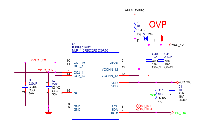

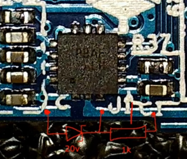

Pinecil 24V mod - alex_grach - 02-22-2022 Hello. Here is my solution to make Pinecil work with 24V power supply. Simple over voltage protection with 1k resistor and 20v zener diode. RE: Pinecil 24V mod - dreieck - 07-06-2022 So did you cut the connection from the barrel plug to the USB-C-chip and connected the USB-C-chip via 1k resistor and Zener diode to the barrel plug? And the USB-C-connector is still directly connected to the chip? Or what changes you did on the wiring? Regards!  |
