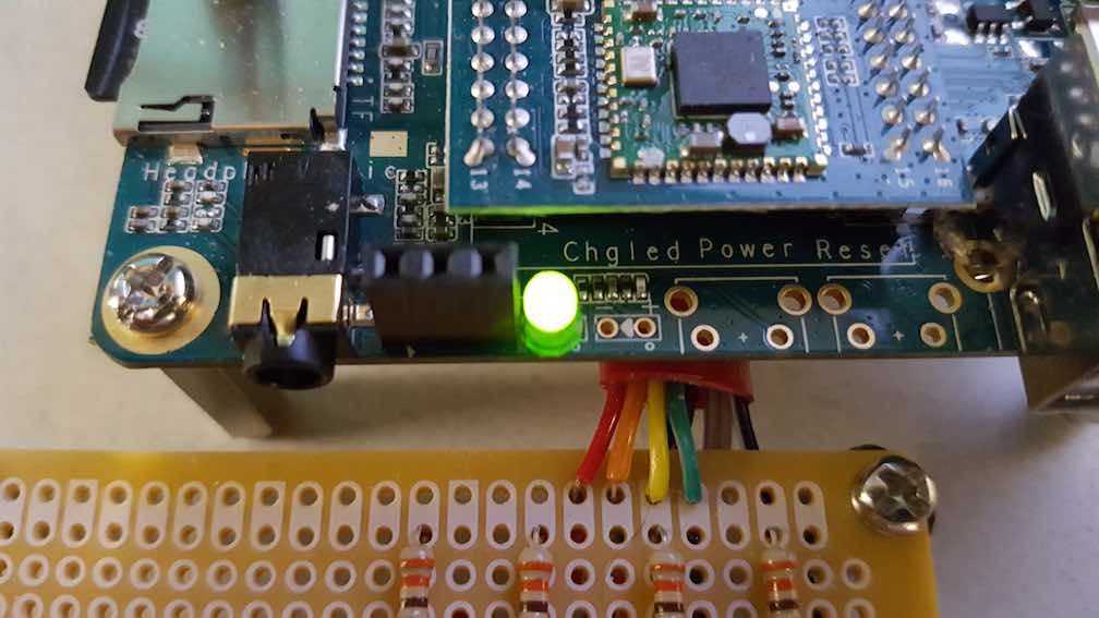

@martinayotte, thanks much... I was in the process of studying the codes for RPi.GPIO/ you saved me a ton of work figuring out the 'number' from name, bank, pin &c.  I did have to make the change above to include the /gpio folder under /class (I assume it was just a typo... I tried this on the debian image, have not tried it on the ubuntu image yet--  see above).  Again, thanks it was a big help !
@longsleep, thanks for the formula script to go from name -> pin number !  voila, wishes do come true !   Rolleyes
I should note (even though its probably obvious) the LED lights on value = 0;  because we're providing the ground shot for DCDC1.
I won't be soldering my test LED in; going to use a smaller (3mm) green LED coming soon.
edit:  here's the final 3mm green:
