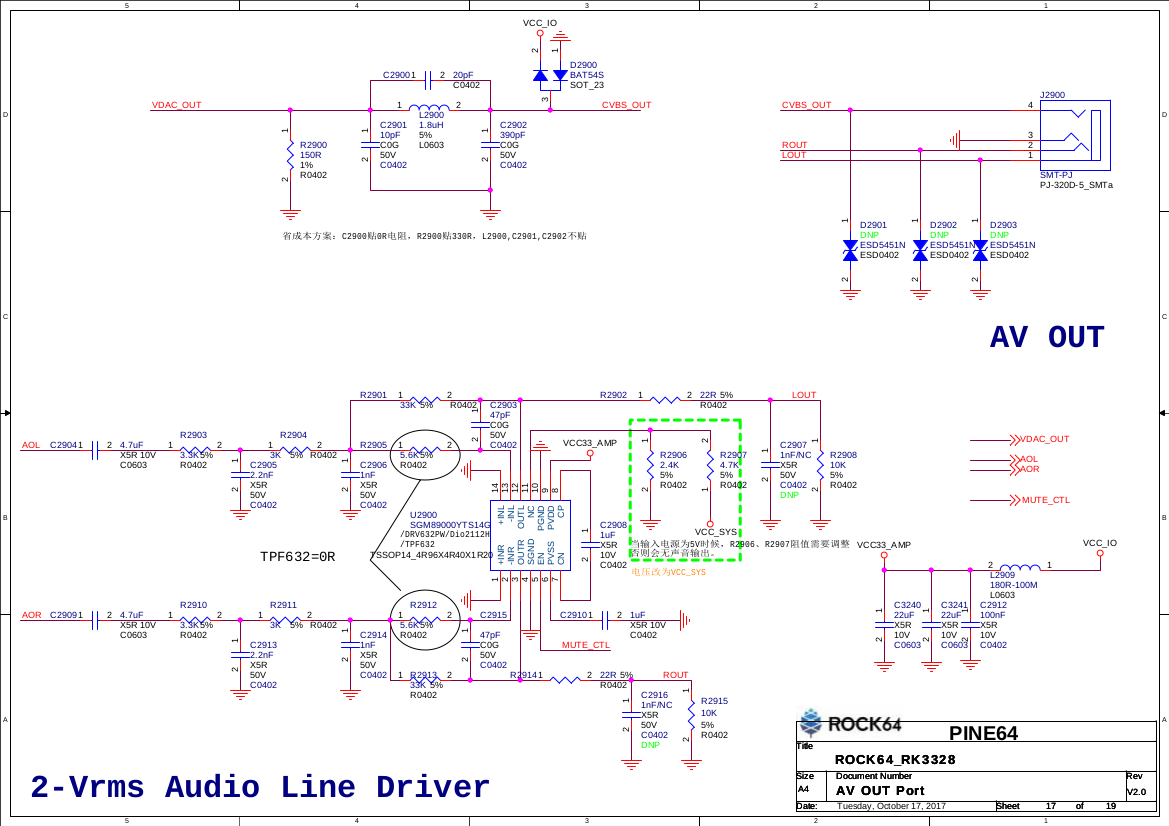

RE: 0.7.9 Linux release from ayufan - ab1jx - 08-06-2018
The schematic page 17 shows this audio circuitry but I don't know how you access it from software.
