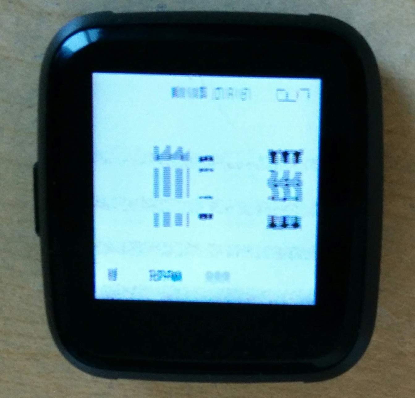

I just received my PineTime dev kit. The battery charged ok and the watch face lights up when the button is pressed but the touch screen doesn't work.
I cant change screens and when you hold the button to power off the buttons don't work.
Looks like the touch screen is broken. Are there any other reports of this?
After some more testing the screen has now lost all color -

The garbled screen can be fixed with hard reset.
I had to restart several times but eventually the screen came good. All fixed now ?
