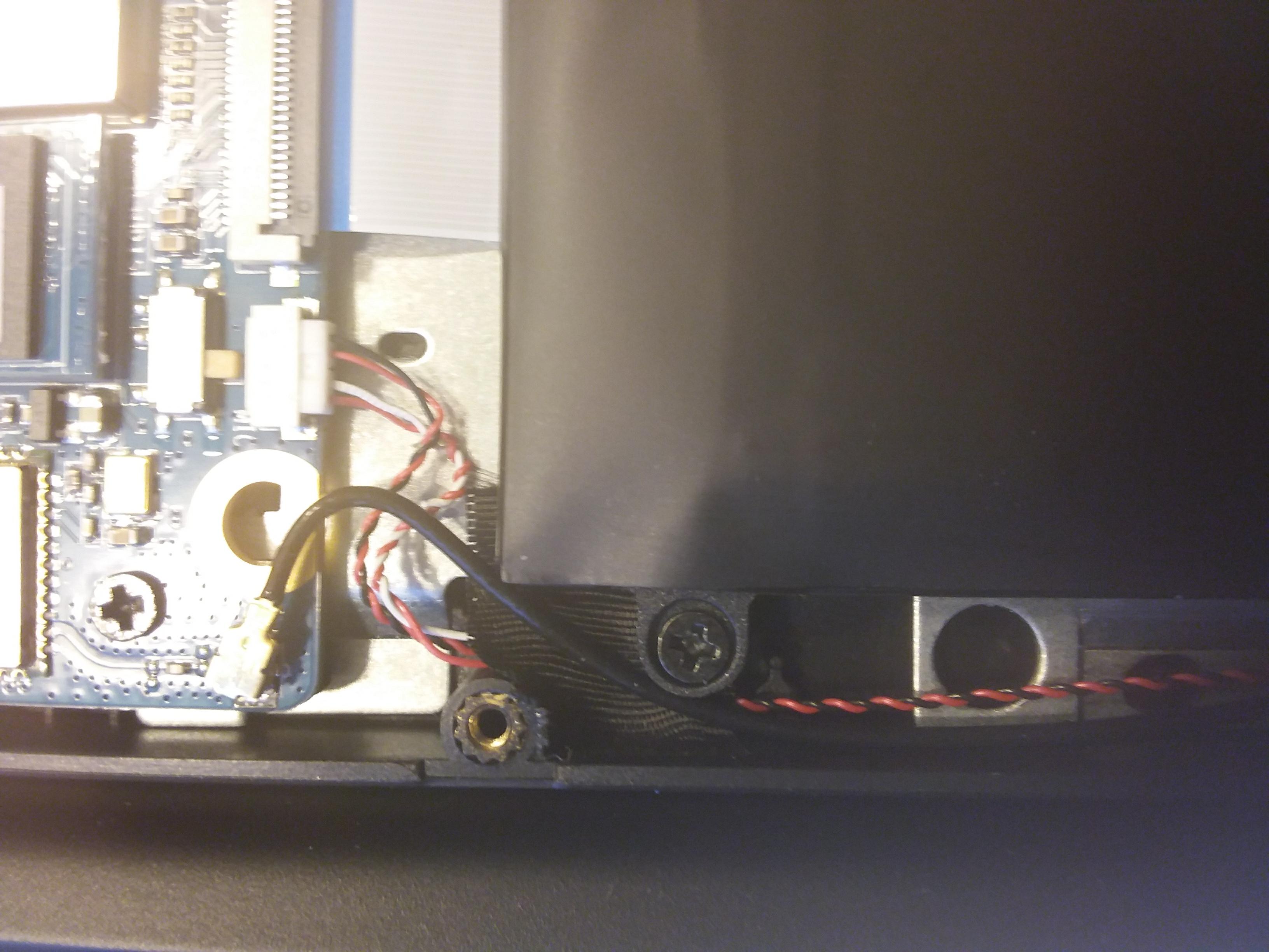

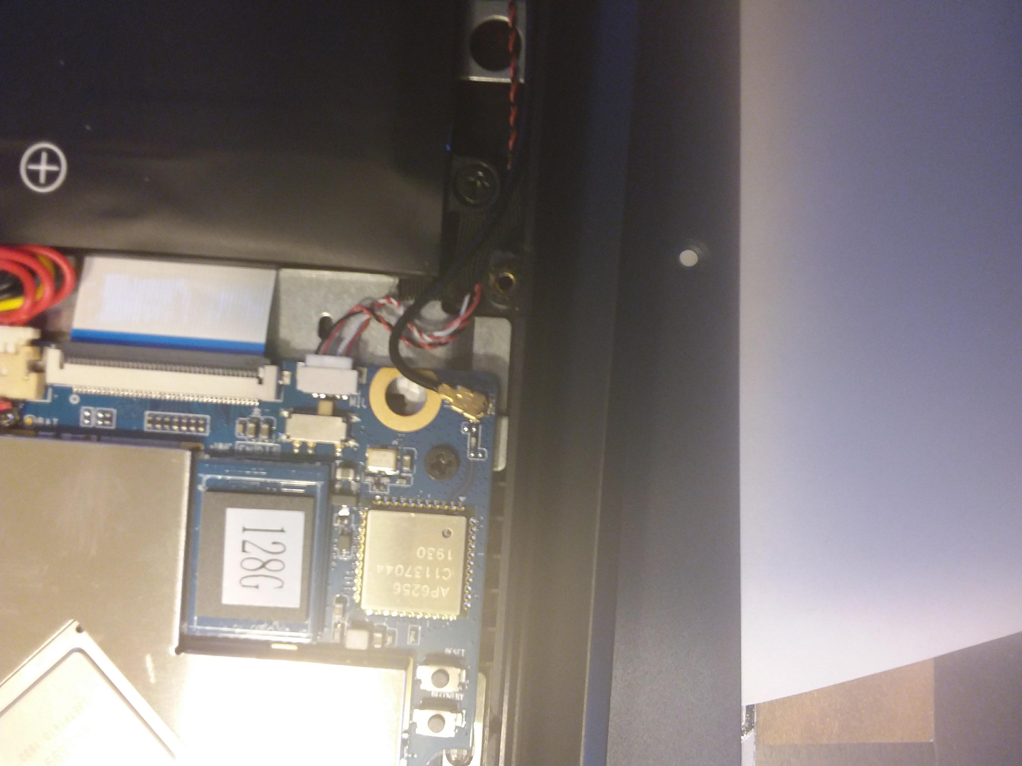

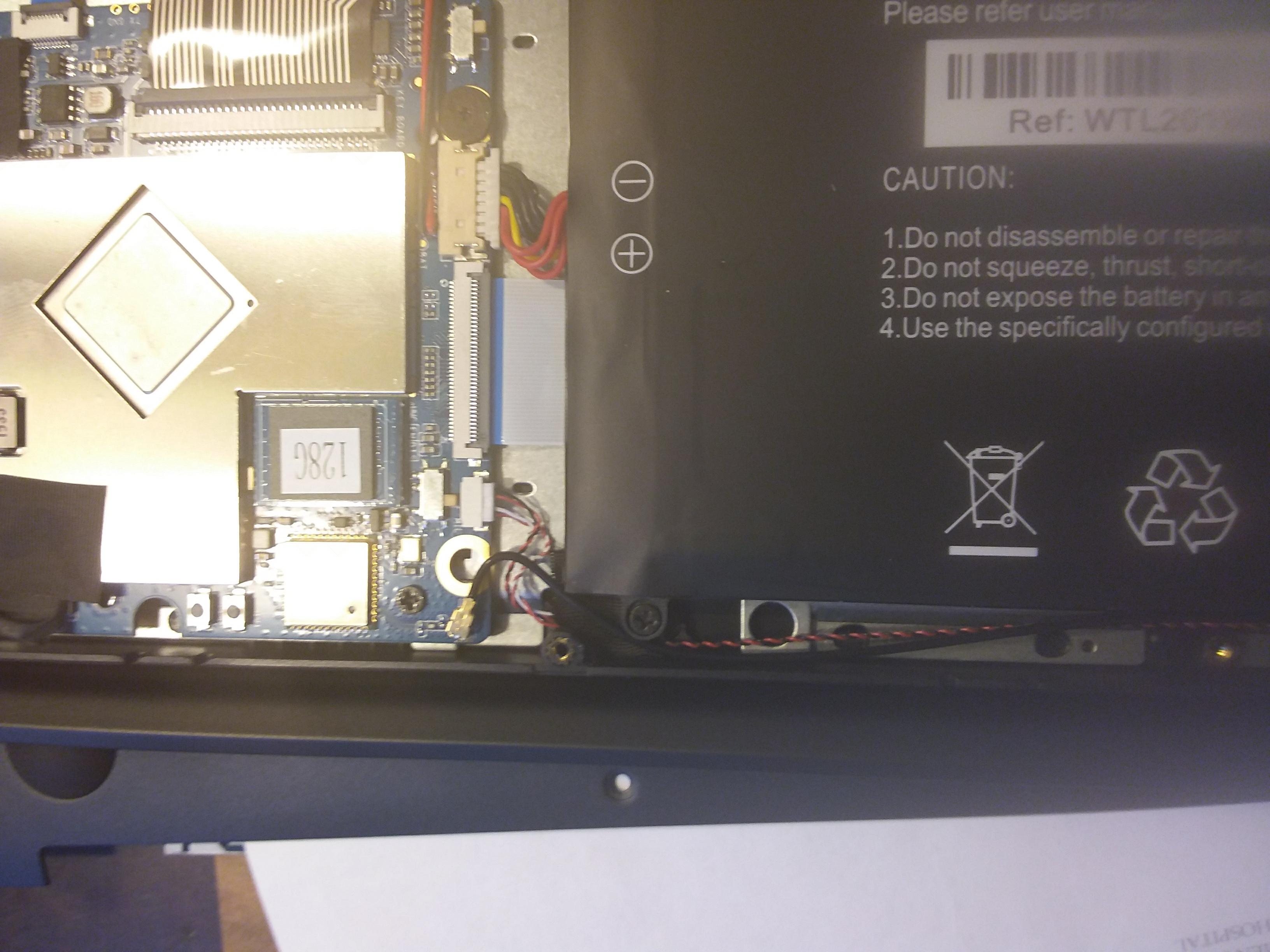

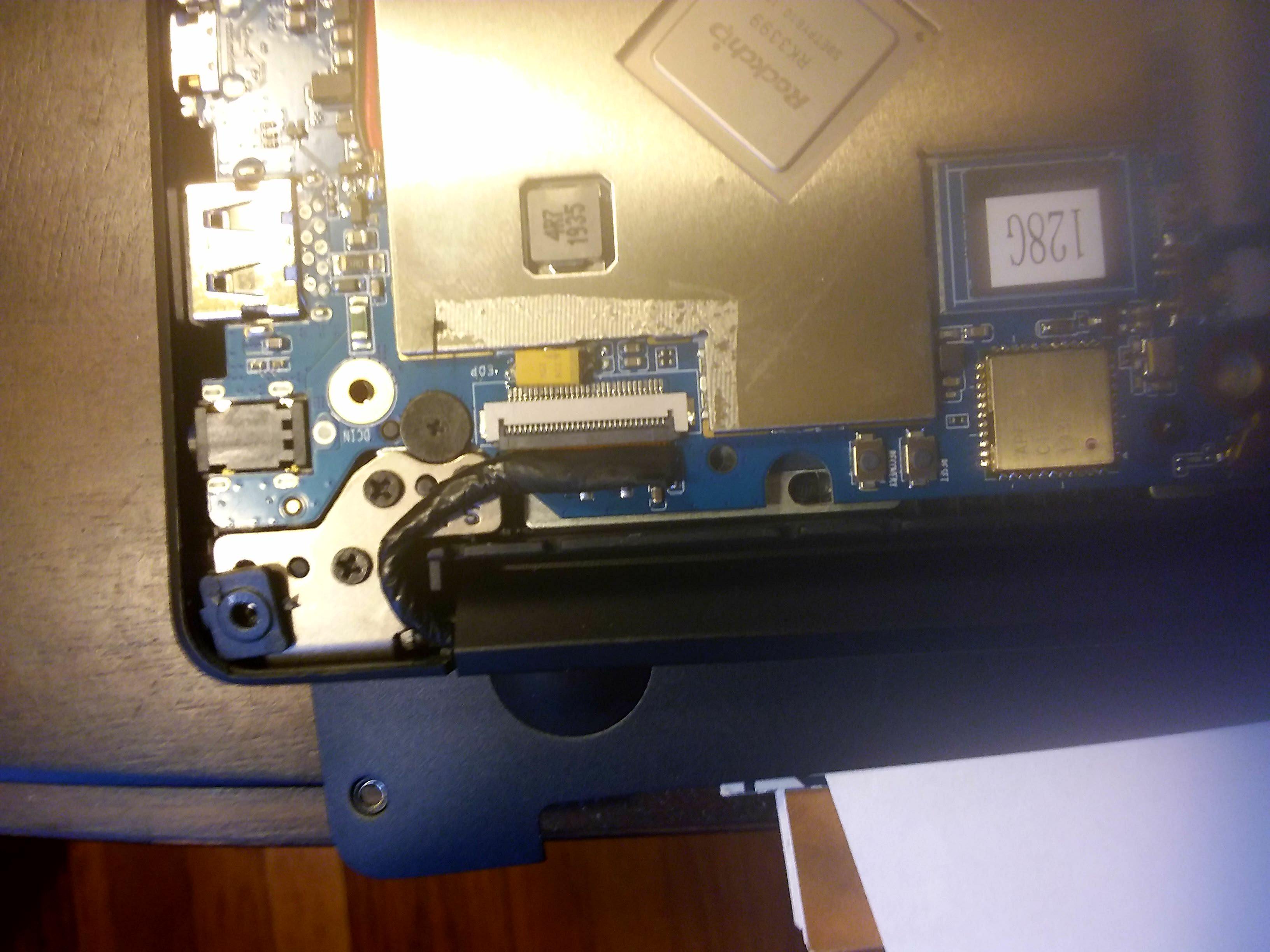

I opened the bottom of the PBP and compared the layout to the specifications picture on the wiki. It looked the same as the wiki photos. I checked the antenna connection after removing the tape. It seemed to be seated firmly. So I replaced the tape. I didn't touch anything else but screwed on the bottom panel.
Does anyone see anything wrong with the wifi antenna or the connections? I'm sending these pictures to the Pine Info team.
